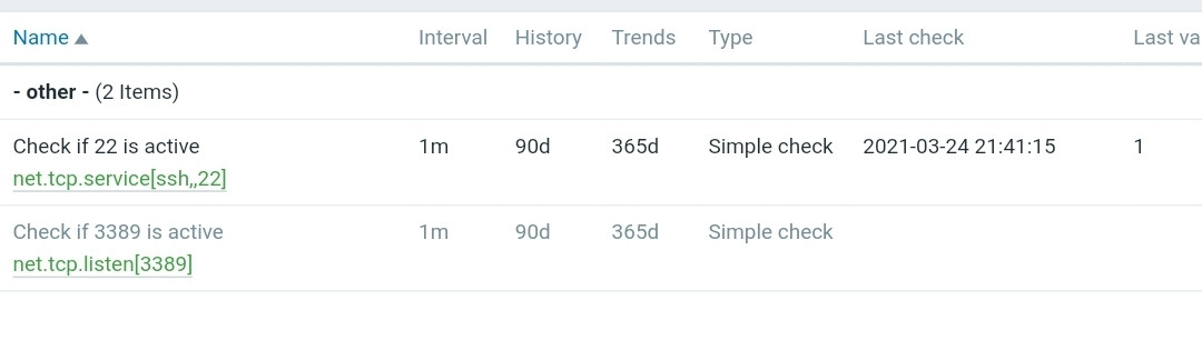

    Can i monitoring RDP port without agent installation on the target?
    i want use simple check
    Ssh works fine but 3389 command is not recognize
    I ll expect a value=0 but it s grey

    It is because net.tcp.listen does not falls in simple checks. It requires communication with zabbix-agent.

      The correct simple check key would be
      net.tcp.listen[,,3389]

        net.tcp.listen[port]
        - not simple check, but agent.
        for rdp test you tray use net.tcp.service[tcp,,3389]

          Sorry, I meant, for simple check use
          net.tcp.service[,,3389]

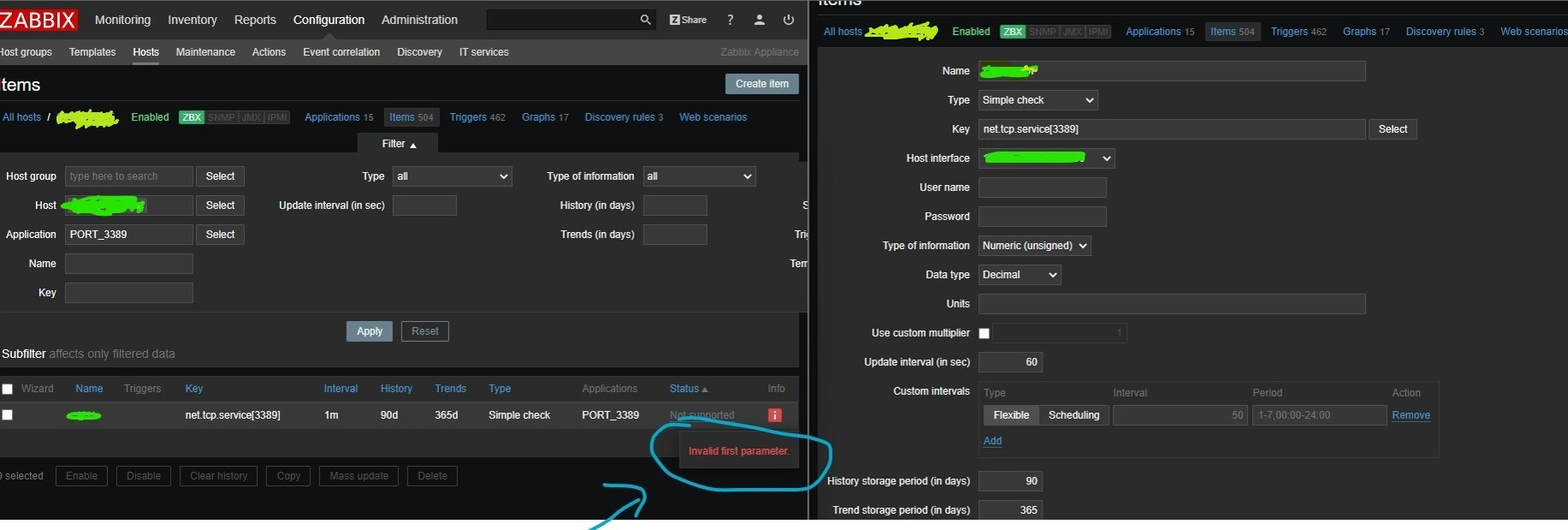

            I have problem like this: Atachment
            I just want to check if rdp connection is possible - I have a problem with that
            I don't know where this problem comes from: Invalid first parameter
            I have tried various entries:
            net.tcp.port[rdp]
            net.tcp.port[,3389]
            at some point he showed up another error:
            unsupported items
            What am I doing wrong ?

              • enik9123
                • Apr 2022
                Hi Atsushi
                I use net.tcp.service[,,3389] but i have still the same problem:
                • enik9123
                  • Apr 2022
                  Now, i have error:
                  Unsupporeted key item

                        • enik9123
                          • Apr 2022
                          Atsushi - rdp is not in service list in simple check
                          service - possible values: ssh, ldap, smtp, ftp, http, pop, nntp, imap, tcp, https, telnet
                          (net.tcp.service[tcp,,3389]) - doesnt work
