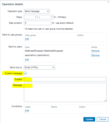

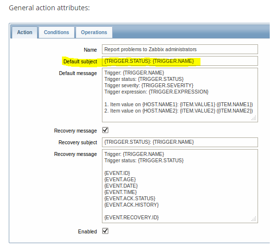

    til zabbix 2.4. it was possible to change the "default subject" in an Alert Message, so I could see from which "host.name" the Alert was generated.
    where I used: 'Default Subject': {HOST.NAME} {EVENT.NAME}
    from 3.0 it is not longer possible.
    The Menue changed, I can "only" use a custom message, but there I have to define the "subject" and the "message".
    Therefore I have the following questions:
    1. it is not longer possible to change the "Default Subject" ?
    2. Any idea, what are the "default message" parameters ?
    3. another workaround could be to use the "host.name" directly in the Trigger Name, but the I see it double in some other usecases, eg in the "problem widget", where I have a field "host" and "problem" ( where the trigger name appeared.
    Any help or other ideas would be helpful
