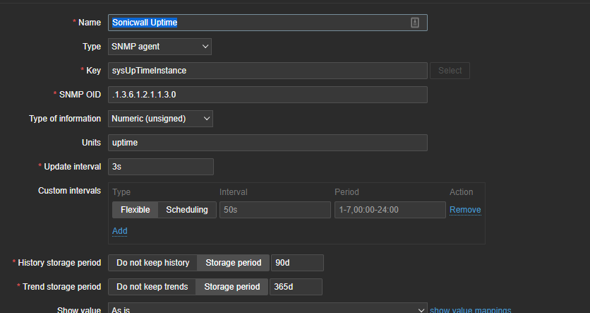

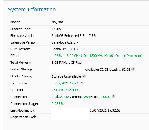

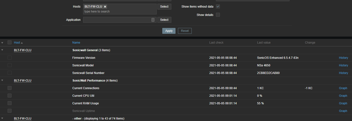

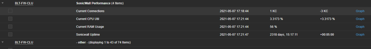

      Thanks for the quick reply, I made the changes you had suggested, but I still get an odd value, very close, though.
      This is the snmpwalk
      user@server:/home/derli# snmpwalk -Ona -v1 -c "comunnity" 192.192.192.192 DISMAN-EVENT-MIB::sysUpTimeInstance
      .1.3.6.1.2.1.1.3.0 = Timeticks: (200371476) 23 days, 4:35:14.76
      I have uploaded screenshots of the real uptime, the uptime item from zabbix and the screen from the latest data.
      By the way, I am running zabbix server version 5.2 on an Ubuntu server 20.4, the sonicwall is behind a zabbix proxy also running version 5.4... I am getting snmp traps using SNMP v3 with SHA and AES as authentication and privacy protocols respectively.

        first: timeticks = 1/1000 sec
        second: uptime prefixtranslated from seconds.
        use preprocessing to fix it.
