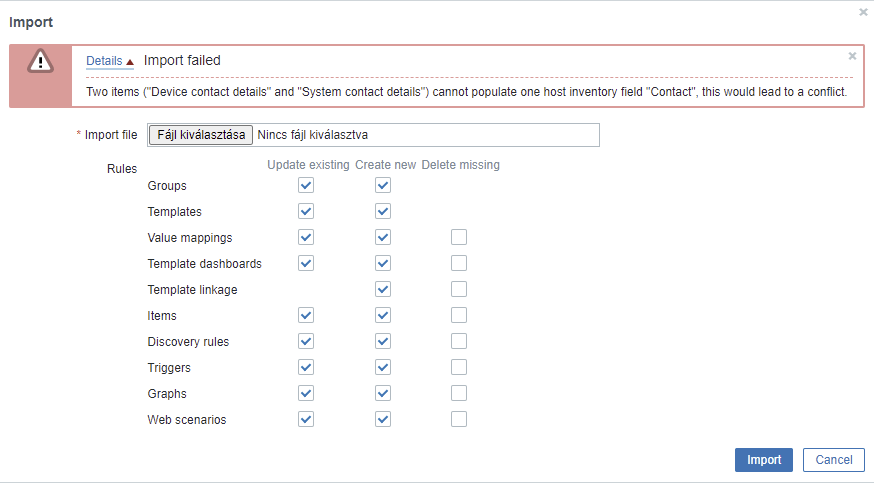

    When I tried to install "Template Module Generic SNMPv2", I got error "Two items ("Device contact details" and "System contact details") cannot populate one host inventory field "Contact", this would lead to a conflict.".

    I've got the same issue. Running Zabbix 5.4 on Ubuntu 20.04 + MySQL + NGINX.
    Import failed
    Is someone know the solution how to solve this problem?

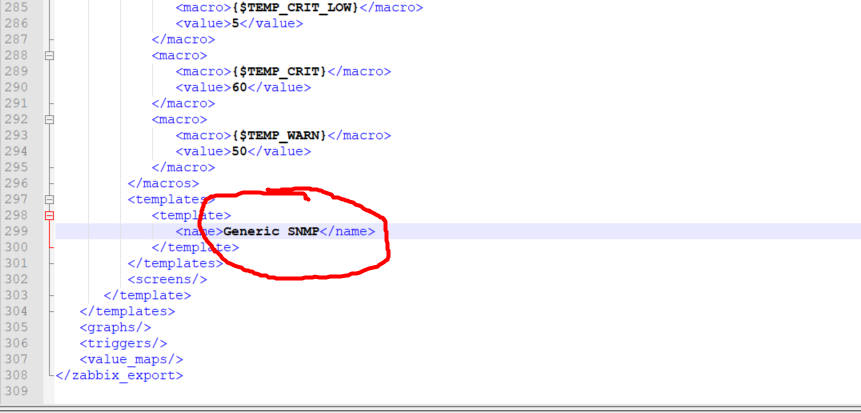

        You don't need to install "Template Module Generic SNMPv2" You need find in your "Template Module Poseidon2" link to it and change to :

        And it will work.
          Since 5.0 it is renamed to "Template Module Generic SNMP" Maybe obtaining a newer version helps?
          Or if it still continues, just open the template file in editor, find one the items and edit out the update inventory part...
          https://git.zabbix.com/projects/ZBX/...Frelease%2F5.4
          find "System contact details", remove line "inventory_link: CONTACT"
          But I think it should not be necessary, if all templates are up to date
