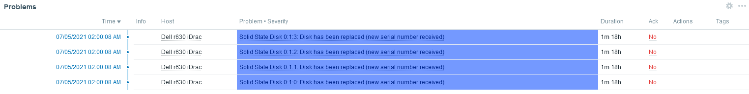

    I have experienced 4 identical problem events stating that my disks have got new serial numbers. But I have not changed any hardware or rebooted the server when Zabbix alerted the problem. Should I ignore this issue or what should I do?
Name:	Screenshot 2021-08-04 203733.png
    I have a Dell PowerEdge r630 server with 4 Intel SSD disks in raid controlled by a raid controller (PERC 730P Mini).
    I'm running Zabbix 5.2.6 in a Debian 10 VM on my XCP-NG host.
    Any help is highly appreciated

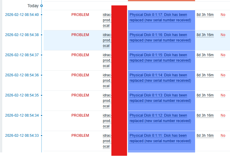

        • RichardA
          • Feb 2026
          Also had this problem with Dell AX-740XD stack. Dell servers themselves don't show any issues. There was no reboot (that i know of ) and no updates done. Just suddnely appeared one morning in the logs.Click image for larger version

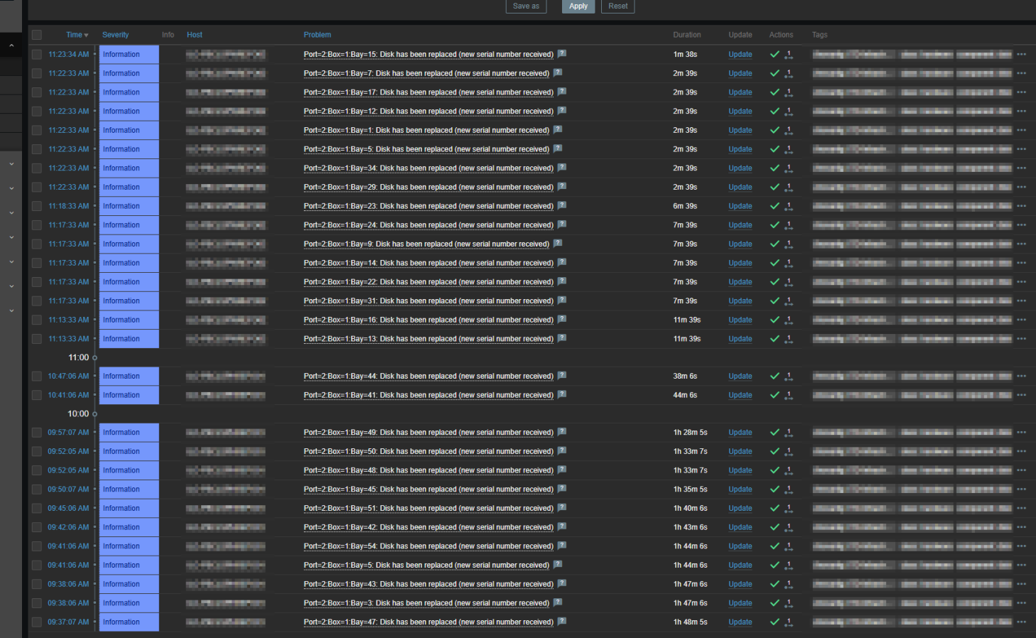

            I am encountering the same problem on a couple of HP servers when using the "HP iLO by SNMP" template
