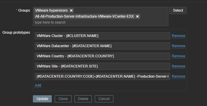

    I managed to solve this issue myself, course i now have issues where some host prototype groups seems to be detected on first run then are flagged for deletion on the second discovery run.. are there certain limitations on these ??
    Below is the hostprototype hostgroups.. All the VMWare * ones work the last one however does not, and the extra MACRO's are the new ones i have added in the post processing.. So on the first discovery no problem, any additional it marks that last group for deletion as it already exists... I am unsure why this is happening.
