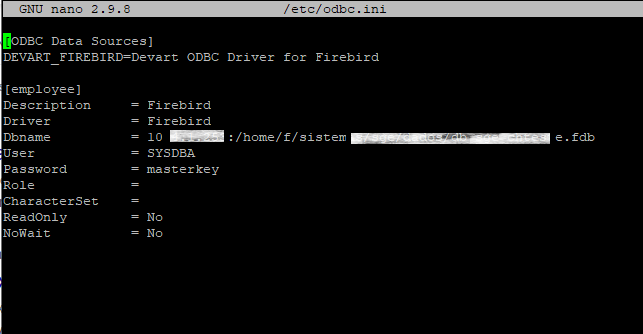

            the odbcini
            what am I missing?
