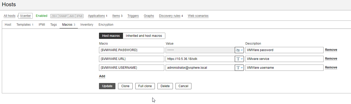

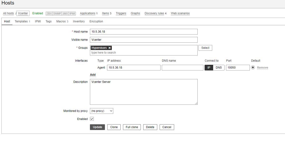

    My settings are like this:

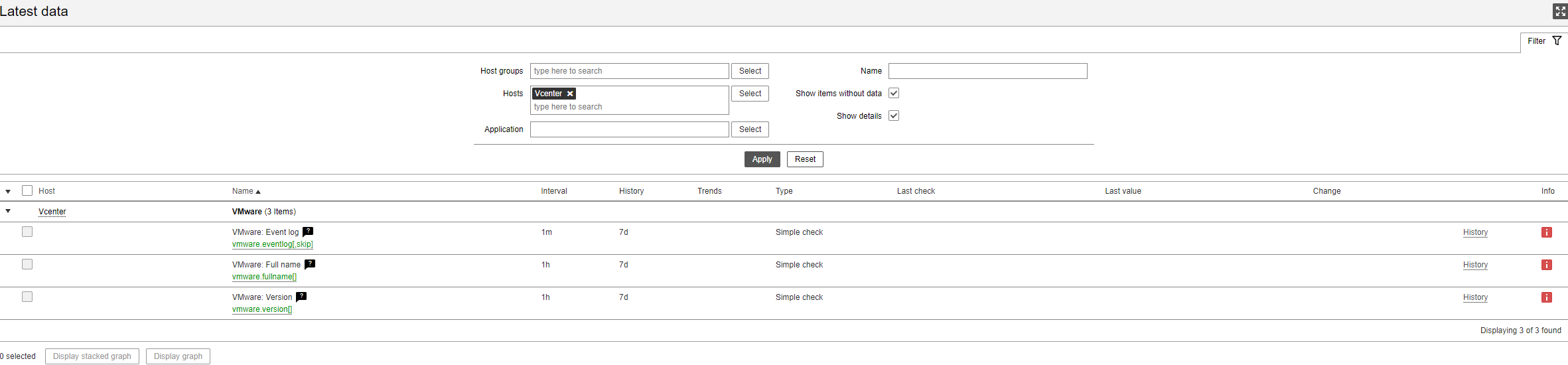

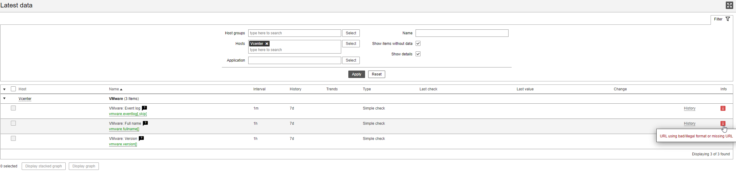

    Status of Vcenter in Zabbix is like that:
    Any ideas what is going wrong?
    Cheers, toddehb

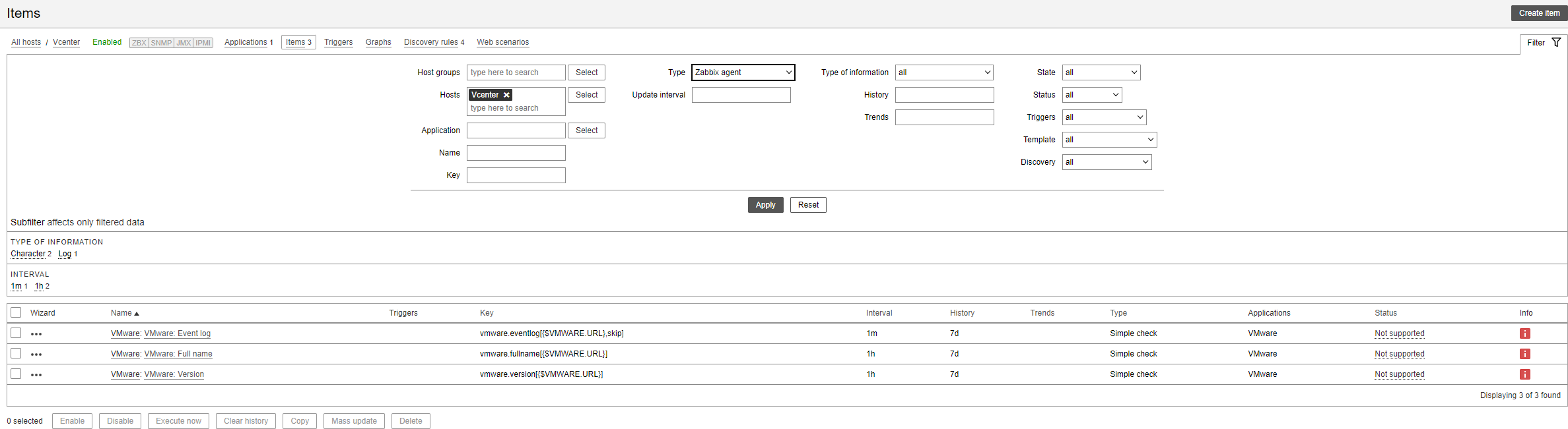

          This is shown on the items page

            Found this info

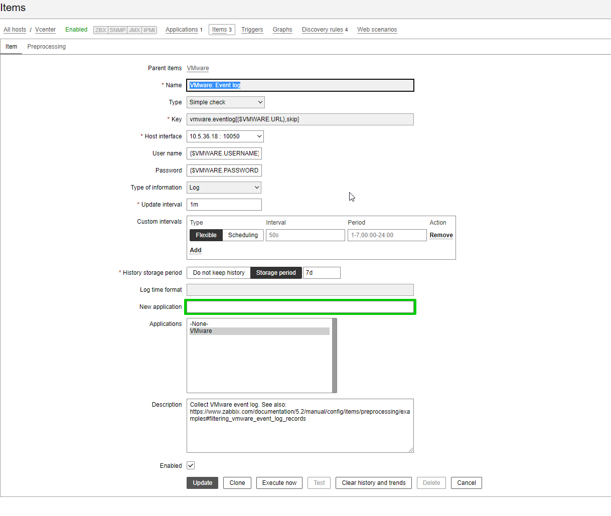

              Something is confusing me. When I go to details of an item, then it is using $VMWARE.USERNAME, allthough I defined unly $USERNAME in macros. $VMWARE.USERNAME is for Zabbix 5.4x as I found in some articles
              • toddehb
                • Nov 2021
                • 16
                It's working now. Re-created host, used naming convention of 5.4x and all VMWare guests are now populated.
