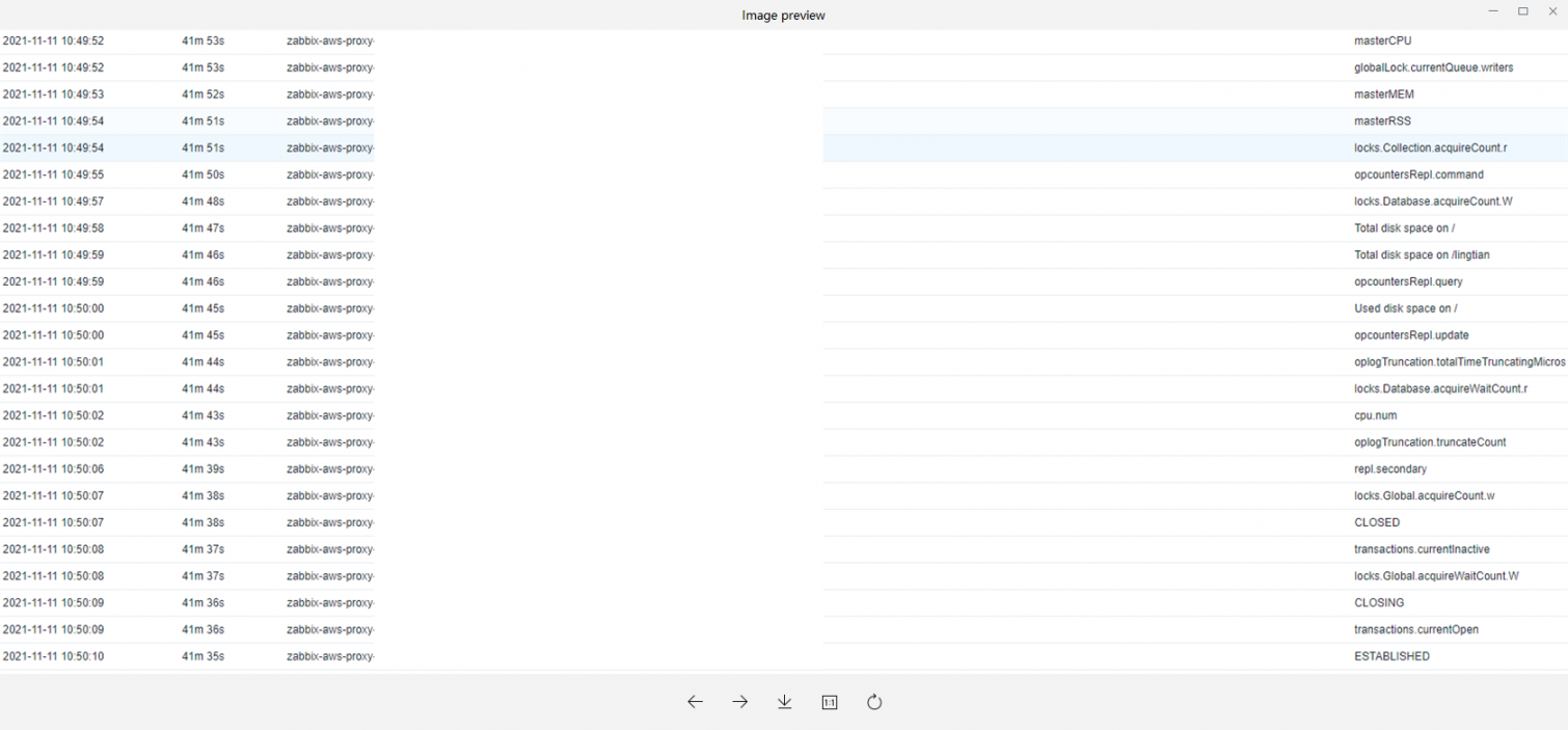

    When the server got an issue or be turned off. Then the Zabbix proxy will try to pull metrics every 15s, it will be queued in the proxy queue.

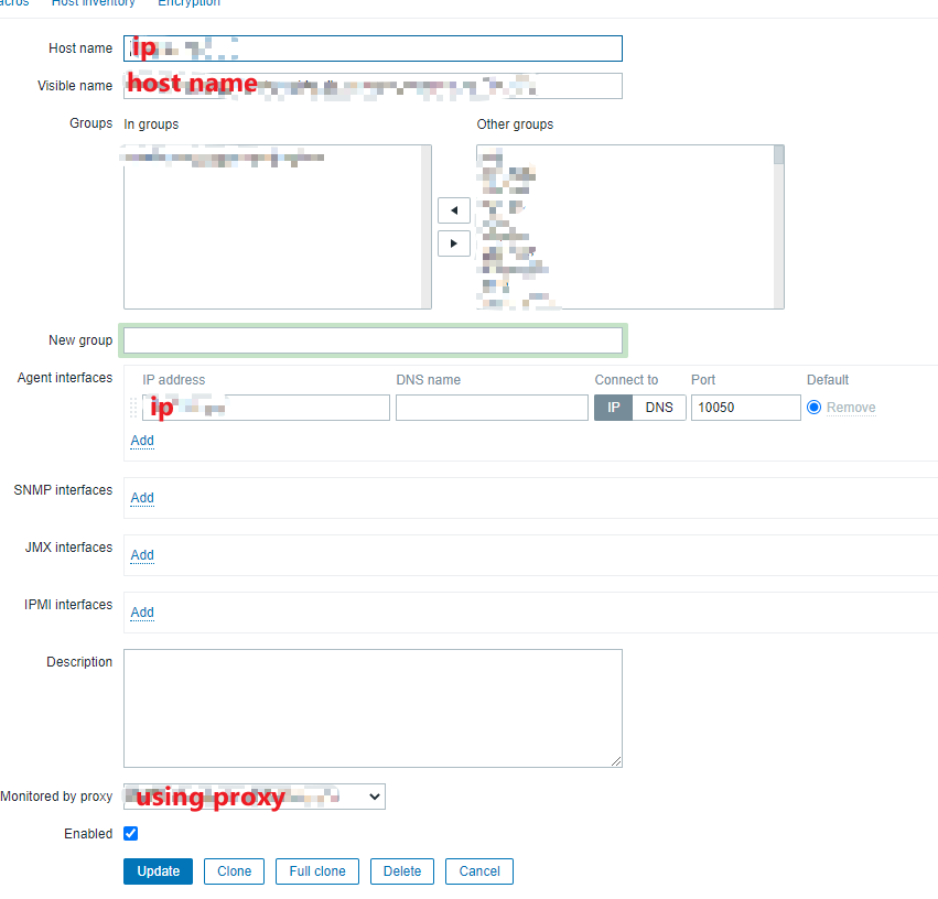

    Well, this seems useless as the Zabbix agent is unreachable by the Zabbix proxy.

    zabbix host configuration :

      Thanks for your reply niveastn.
      For 1 this will not help at all. We already tried to increase the UnreachableDekay, but whatever the delay is set the unreachable server still will be polled after the delay passed. We do not expect unreachable's keys beyond agent status to be tested.
      For 2 is impossible to set maintenance, this is caused by server down incident, is not a predictable issue.
