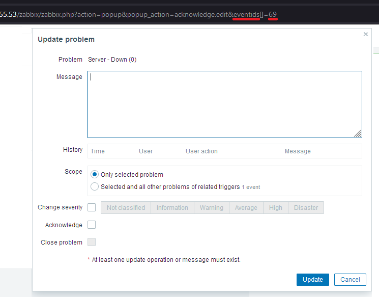

    Colleagues, how can you get and transfer the value of eventids to the script. Tried using the {EVENT.ID} macro, doesn't work
    /usr/lib/zabbix/externalscripts/ssh.py --ip {HOST.DNS} --idm {EVENT.ID}
    https://www.zabbix.com/documentation..._by_location?s[]=macros
    Click image for larger version  Name:	sf34.png Views:	0 Size:	25.3 KB ID:	435571
    Any ideas anyone ?
    thanks

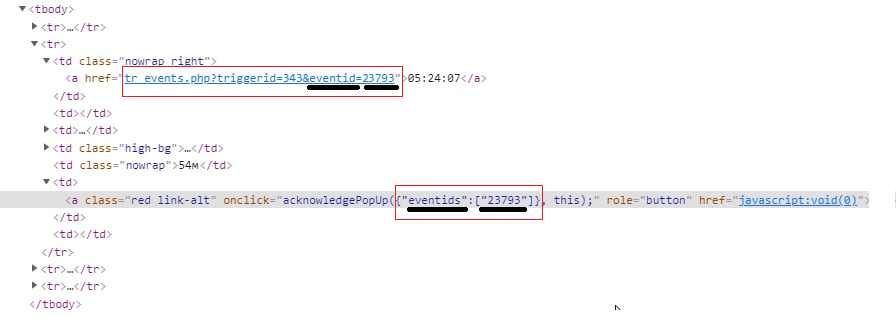

      I have a working python script that runs after a trigger fires and comments out an event. But for it to work through zabbix, it needs to get the value of eventids. VIDEO https://disk.yandex.ru/i/gPzUZJM8gHhfbQ (set high quality when watching video)
      I tried to create my own {$mymacros} macro and then pass the value of the macro to the script, it works. But that doesn't suit me because I have a lot of devices.
      can I somehow get the value of eventids via api or via frontend?
      I don't want to use web scraping

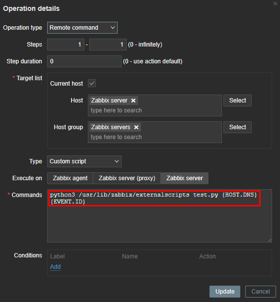

        Hey booblik, I think I may have a solution to help you with this issue.
        First thing you need is an action to run this script automatically when the trigger is fired, and you can pass a remote command to run your script, while it receives {HOST.DNS} and {EVENT.ID} as parameters as the following:
        Inside your python script you can import the lib "sys", and pass those parameters as variables:
        That way, you can easily point it into the Zabbix API JSON body to ackonowledge the event.
        Use the variable "eventid" inside "message: ", and it will always display the EventID in the message.
        Hope this helps you somehow.

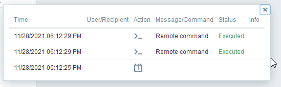

          Why is the action repeated twice?
