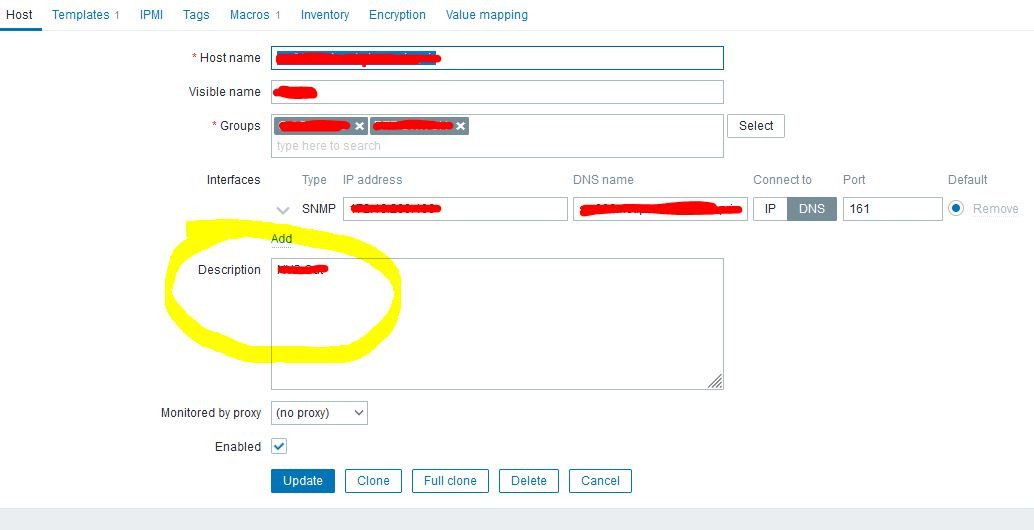

    Hi
    I would like to insert Host description in message template. I try to do this witch macros, but without success.
    Now my message template is the default, for "Problem":
    Host: {HOST.NAME}
    Problema iniziato alle {EVENT.TIME} del {EVENT.DATE}
    Nome del problema: {EVENT.NAME}
    Severity: {EVENT.SEVERITY}
    Operational data: {EVENT.OPDATA}
    Original problem ID: {EVENT.ID}
    {TRIGGER.URL}
    I would like to insert for exemple:
    Location: {$HOST.DESCR}

    Hi there.
    Please reference a list of supported macro. You will see, that host description is {HOST.DESCRIPTION} and not {$HOST.DESCR}.
    Hope it helps.

      Hi ISiroshtan,
      thank you, it works!
