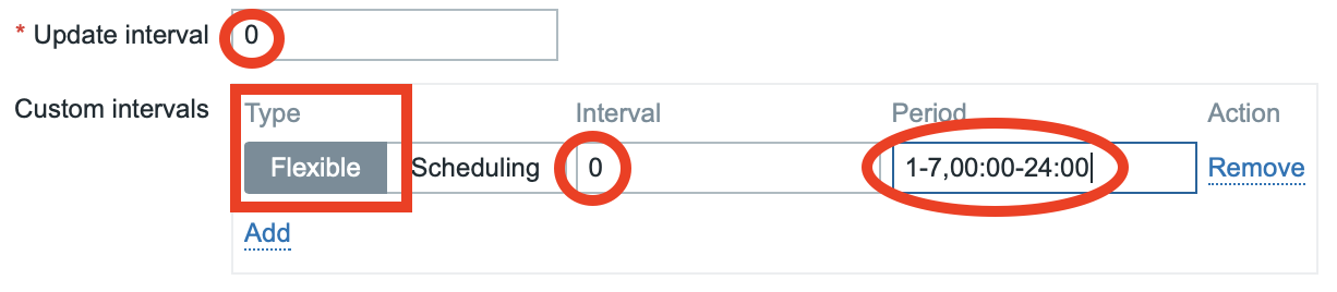

      You could try flexible interval with
      1-7,00:00-24:00
      This should be saying, skip all 7 days of week.
      Click image for larger version  Name:	Screenshot 2022-01-19 at 14.14.18.png Views:	0 Size:	39.2 KB ID:	438322
