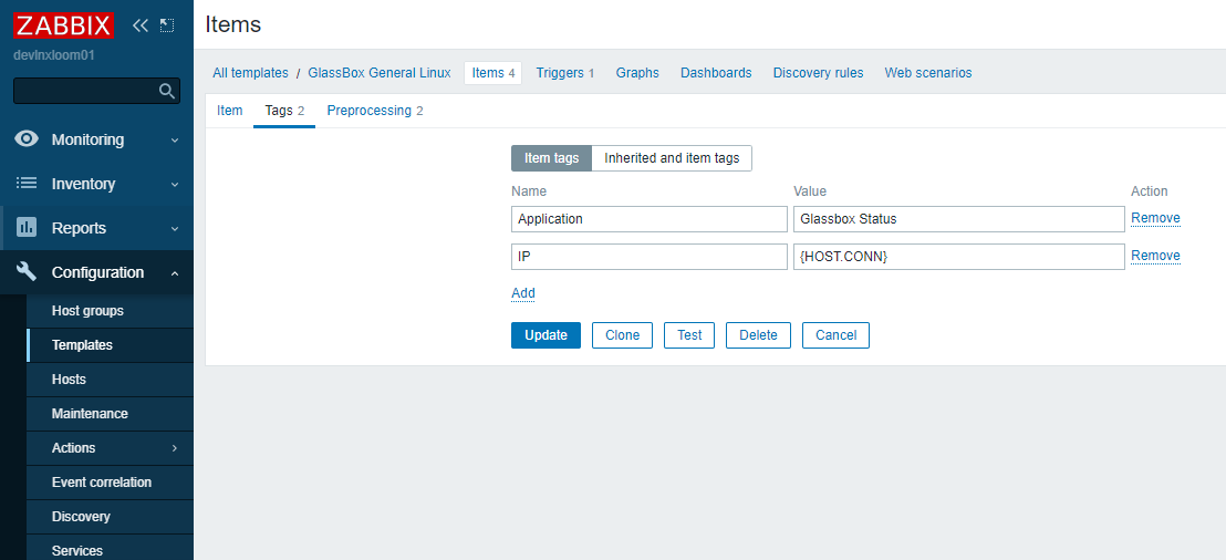

    I added a tag to one of the item based on macro that displays the IP address {HOST.CONN}.

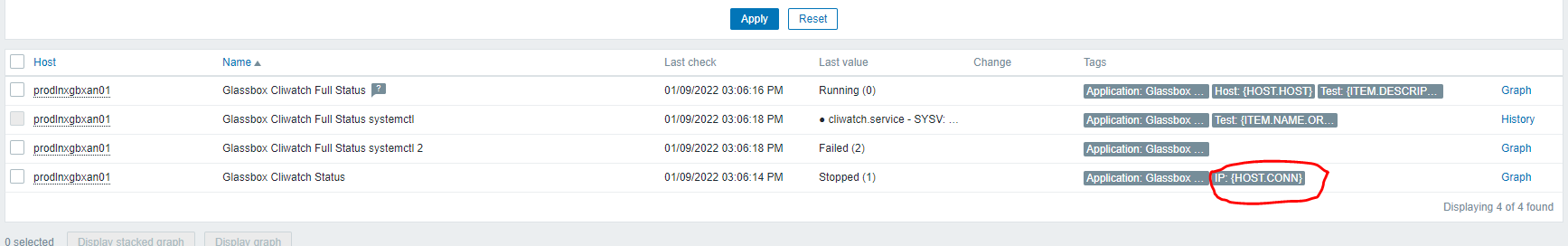

    When I look at Latest Data, the server IP address is not displayed but the Macro {HOST.CONN} See attached file.
    Exactly the same macro is displayed correctly on Trigger, the IP of the server 1.1.1.1.
    what am I missing?
    • 5008
    Your pic also show all other macros ({HOST.HOST}, {ITEM.NAME} etc. )not being expanded. And that's how they are, not expanded.
    Using filter
    You can use the filter to display only the items you are interested in. For better search performance, data is searched with macros unresolved.

      Thank you for the answer but it's not what I asked.
      Why do not I see in Latest Data the IP address (1.1.1.1)?

        In that circled place on first pic?

          Yes exactly.
          It is a bug?
            • 5008
            Originally posted by moshe
            Yes exactly.
            It is a bug?
            No, I gave you exact explanation from docs... Somehow you thought its not what you asked... I cannot give any other answer to that, but just repeat... macros are not resolved there.. not a bug, by design... As you see from your own pic. no macros there are resolved, not just host.conn....

              So how do I display the server's IP address in a tag?
                • 5008
                Okay thanks for the answer.
                They will be expanded if your trigger fires and problem is created (for example on problems page, you will see everything as you need) . they are not expanded just on those config pages.
