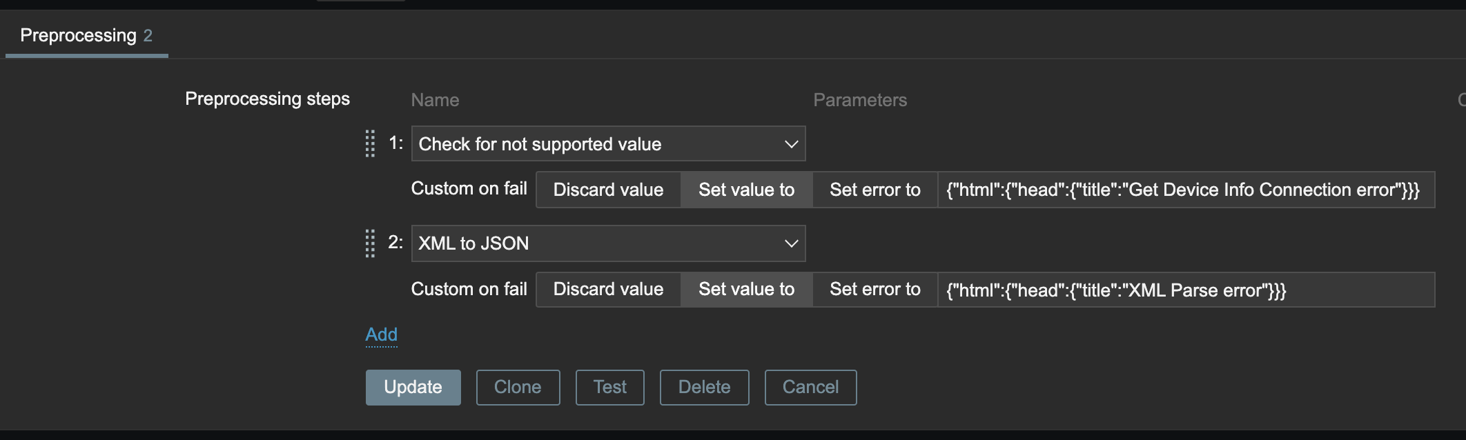

      What would constitute an "unsupported value:" in this case? It's an HTTP agent check.
