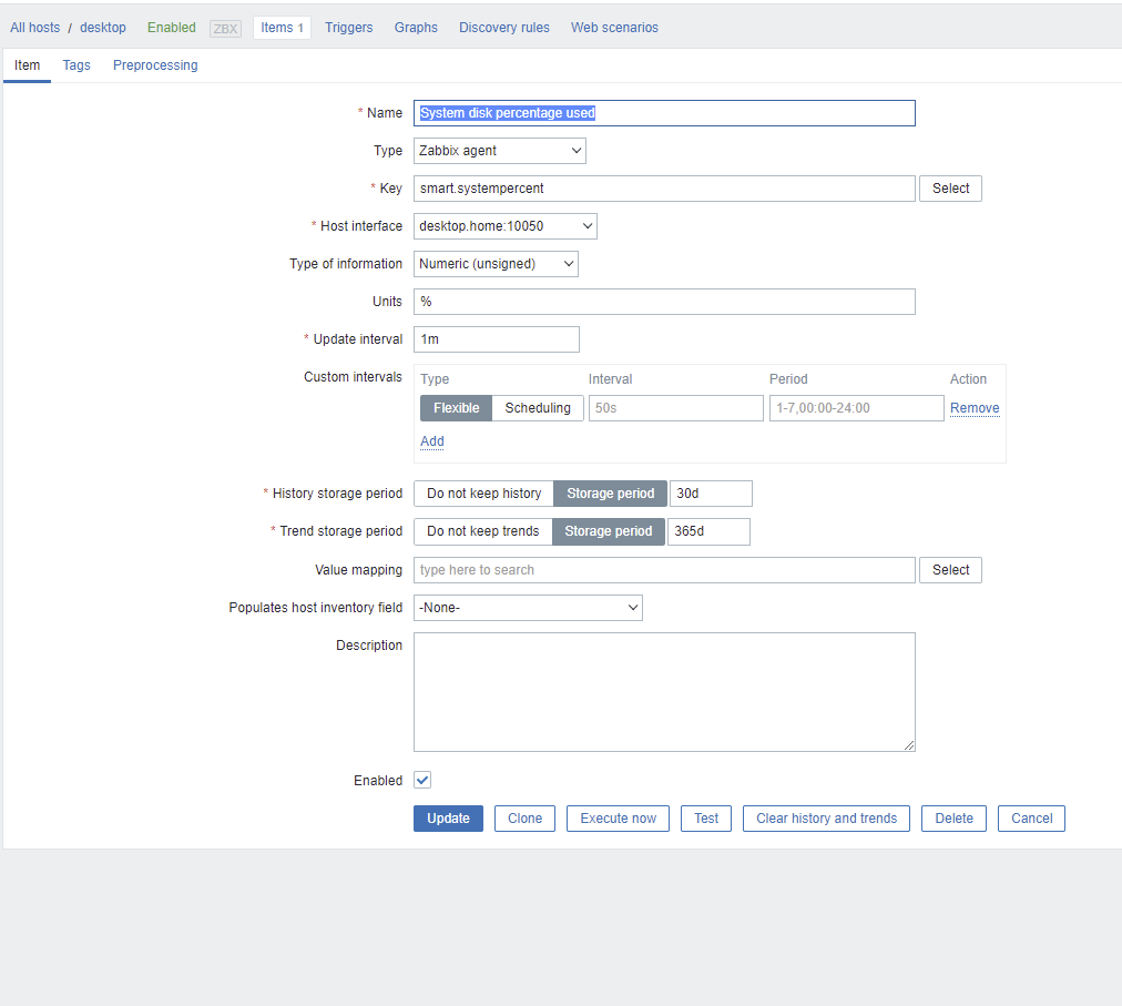

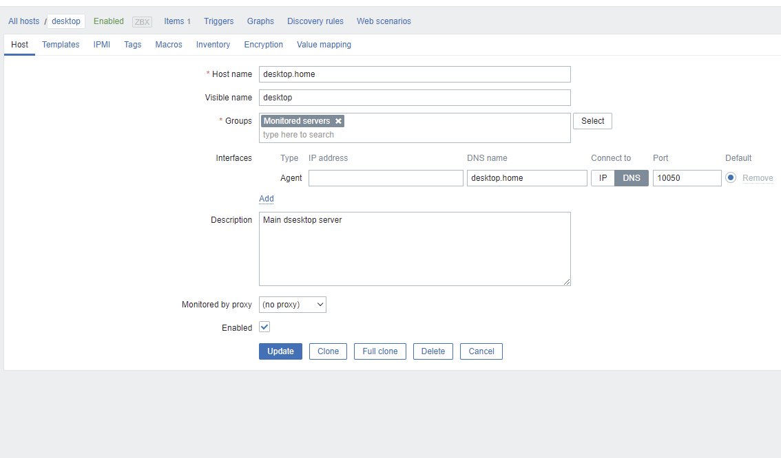

    Clean install of Ubuntu and Zabbix 5.4. I already have some Linux machines that I've been running Zabbix agents on for some years working fine. They have imported perfectly correctly and are working 100% as expected. I have recently built myself a new PC running on M2 PCIe drives so I wanted to add those to the things I monitor. Downloaded the Windows Zabbix agent, installed and setup a user parameter in the .conf file to do some testing. This is the definition of the machine:
    This is the definition of the item:

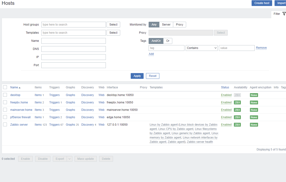

    This all works - I get the data I expect and it updates every minute. However, in the host section, the ZBX icon is greyed out in the Availability column:
    Whilst everything is working fine as far as data collection, I am frustrated that I can't figure out why this happens. I have read quite a few posts now and I believe I am following all the rules (passive item, host enabled etc...).

    Oops. Images didn't come out that well... machine def.
Name:	Honeyview_2022-02-10 13_50_06-Window.png
    Item def:
Name:	Honeyview_2022-02-10 13_51_23-Window.png
    Machine defs showing no ZBXX flag:
Name:	Honeyview_2022-02-10 13_52_49-Window.png

            Kind of interesting: I just checked my Zabbix instance, and the one Windows client OS system I have set to monitor is doing the same thing! The main difference between the servers I'm monitoring is that the default Windows OS template isn't associated with the host. I'm wondering now if the Zabbix Agent Template that's linked to the OS template is what returns the status. As a test, I've added the Zabbix Agent template to my desktop system.
            • rthonpm
              • Jan 2016
              • 44
              I can confirm: adding the Zabbix Agent template, or any template that is linked to it should give you the status of the agent in Windows.
