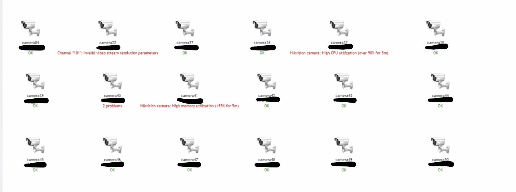

        Busy with the same type of project. I'm using the default Hikvision camera by HTTP template. I created a camera map to display all the cameras. We have 3 NVR's and more than 70 cameras.
        Maybe try to just monitor the cameras separate. I have a couple of managed switches that I also created a separate map for. My next step would be to get or create a template for the NVR's.
