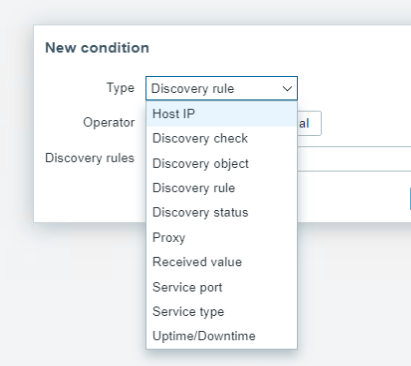

    Hello.
    Running Zabbix 5.0 LTS
    I am trying to send email notifications just for a specific Host Group.
    How can I set an action > condition
    Host group = "Linux Boxes"

      the goal is to get a email alerts on only a group of devices. I am open to ideas.
        • 4970

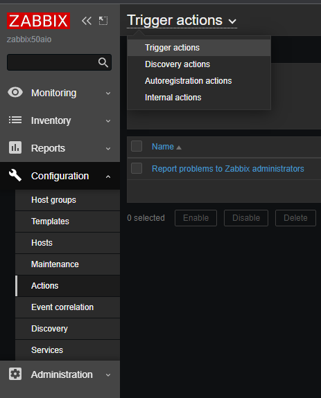

        First of all, choose "trigger actions" instead of "Discovery actions" and you might get a bit more useful list for conditions ...

          I do not seem to options for trigger actions / application. Maybe because I am on 5.0 LTS ?

            • danthemann
              • Mar 2022
              • 10
              Yes thank you that gave me what I need.
              Trigger action
              Trigger name contains Unavailable by ICMP ping
              Host Group equals XX

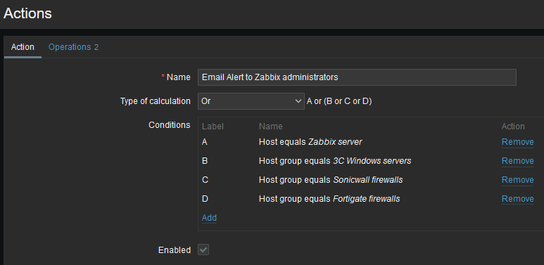

                I ran into the same problem, New action created with a condition to match a specific host group. Host belonging to the group is monitored by Zabbix agent and reported few problems under Problems. No alerts and nothing under Action log. What am I missing please?
                • it.tech
                  • May 2021
                  • 28
                  Here's my action with conditions. Is type of calculation correct ?

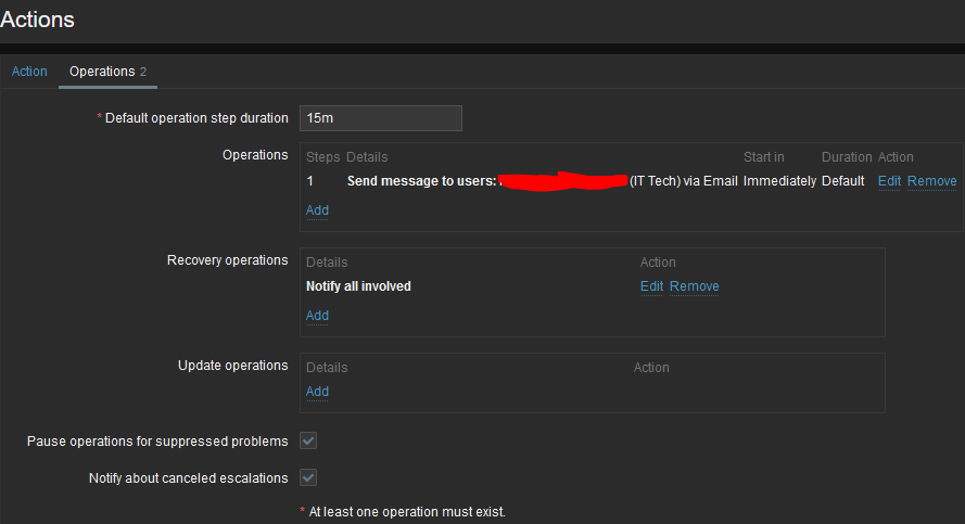

                    And here are operations for this condition.
                      • 4970
                      Does that user, what you covered in red, have access to those hostgroups?
