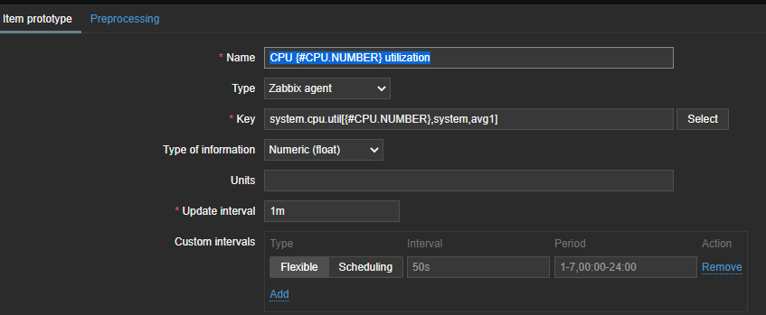

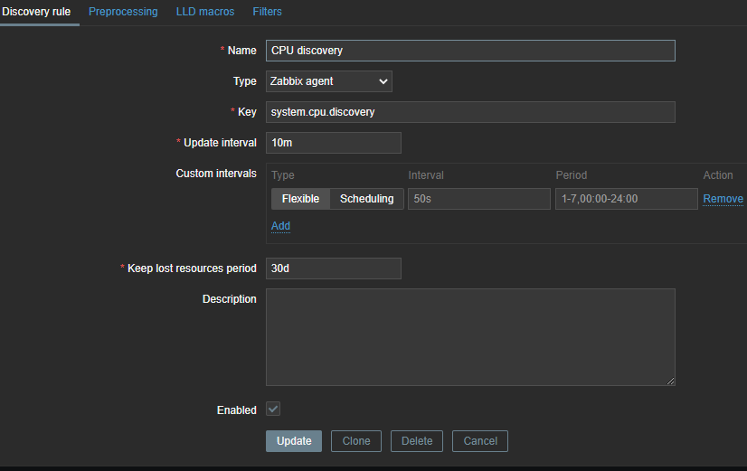

        I took some pics from one of our templates... First is discovery rule... second is item prototype... I guess you can figure out trigger prototype by yourself..
        Type can also bye "Zabbix item (active)" for these.
        Click image for larger version  Name:	cpu_disco1.png Views:	0 Size:	23.9 KB ID:	441110​
        Click image for larger version  Name:	cpu_disco2.png Views:	0 Size:	21.3 KB ID:	441111
