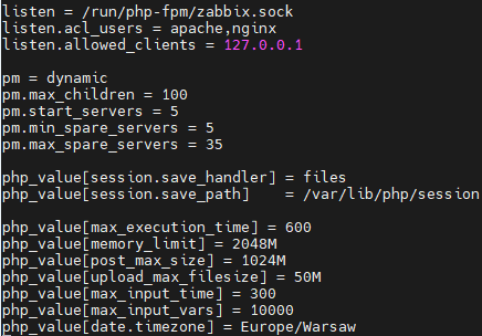

      • ppaciek
        • Nov 2020
        I have the same version of zabbix and the same problem.
        Latest data - running very slow. In addition, templates are sometimes loaded for a few - several minutes (and template files have, for example, 36KB ...)
        There are no bugs with zabbix, apache, php, postgres.
        I suspect this is a frontend problem.
        This is the configuration of the /etc/php-fpm.d/zabbix.conf file:
        Does anyone have an idea how to solve this problem?

          • ppaciek
            ppaciek commented
            Unfortunately, this did not solve my problem.
            I changed this value before, but there is no indication that these are problems with postgres - import template is still taking a long time and the latest data tab works the same\
            I will try to enable debug mode in apache - maybe it will show something interesting
