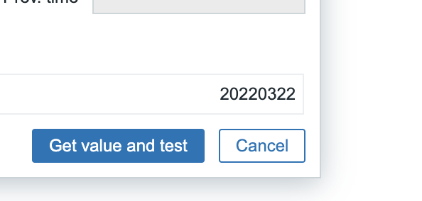

    trigger date
    Hey, I decided to post in the forum.
    I have an item that returns a date
Name:	Screenshot 2022-03-22 at 11.12.21.png
    I would like to set the trigger to react when the downloaded date does not equal today's date. Please help

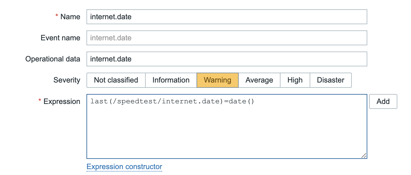

      you will not perform the execution
      I added this way:
      but it doesn't work, I changed the date received by the item to 21 and the trigger does not alert me about the alarm
      • tim.mooney
        tim.mooney commented
        You're using "=" in the trigger expression but you said you wanted "not equal". Isn't the logic of the test incorrect?

      • vitS
        • Apr 2021
        • 43
        Can it be that date() and internet.date in different date format?
        Thanks,
          Then your check should be <> not =.
          Trigger fires when expression condition is TRUE. You want to know, when dates are not equal. So you will test for "not being equal"
