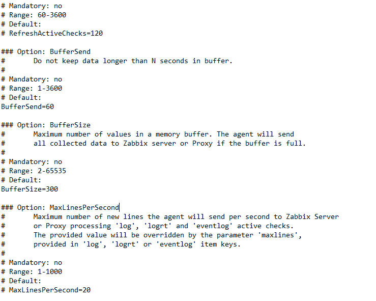

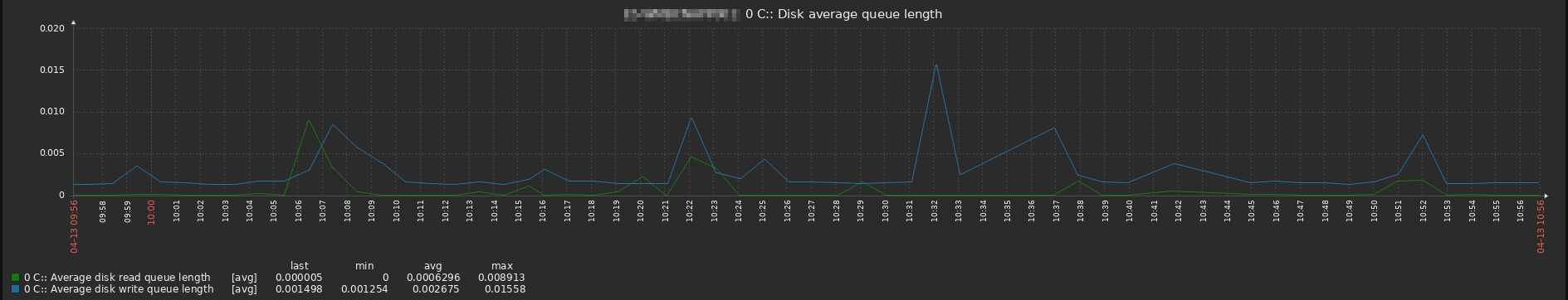

              I am using active agent, I have configured the BufferSize=300 and BufferSend=60,
              I can see that after a failure if I recover some graphs but for example the graphs of CPU consumption and RAM memory are not recovered (I added some screenshots) this may be because of some misconfiguration? also comment that I have applied the template "Windows by Zabbix agent active".
