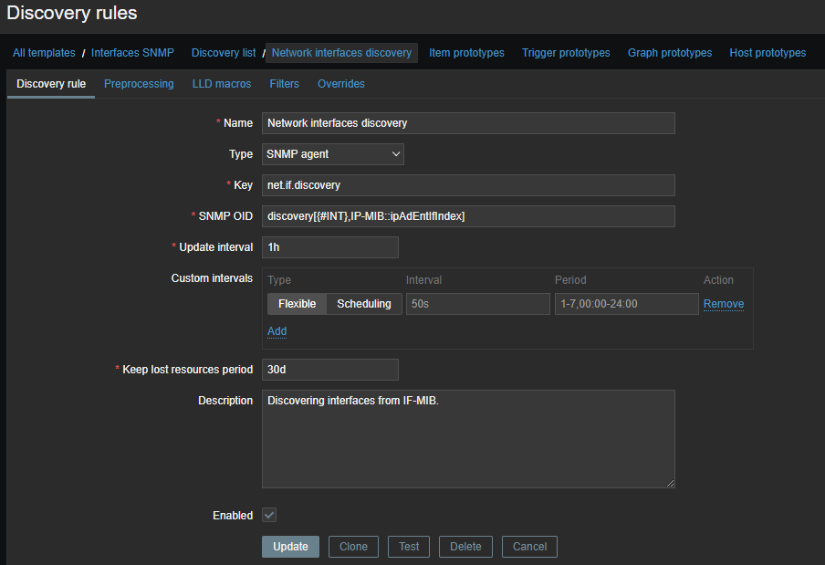

                  Ok, lets make sure the discovery works first.
                  Try this configuration:
                  Key: ifIndex
                  SNMP OID: discovery[{#INT},IP-MIB::ipAdEntIfIndex]
                  Test and it should return the same result of running the snmpwalk:
                  snmpwalk -v 2c -c COMMUNITY IPADDRESS IP-MIB::ipAdEntIfIndex

                    ok, I will recreate all the steps to see where my mistake is.
                    1. Create a new discovery rule

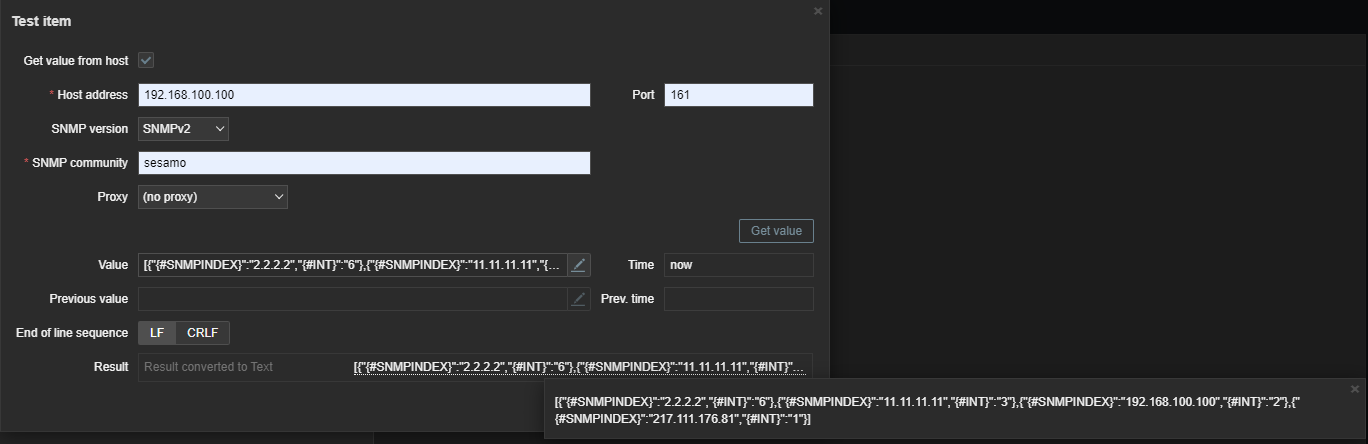

                    2. Server test
                    3. Zabbix test
                    Result:
                      "{#SNMPINDEX}":"2.2.2.2",
                      "{#INT}":"6"
                      "{#SNMPINDEX}":"11.11.11.11",
                      "{#INT}":"3"
                      "{#SNMPINDEX}":"192.168.100.100",
                      "{#INT}":"2"
                      "{#SNMPINDEX}":"217.111.176.81",
                      "{#INT}":"1"
                    • max.

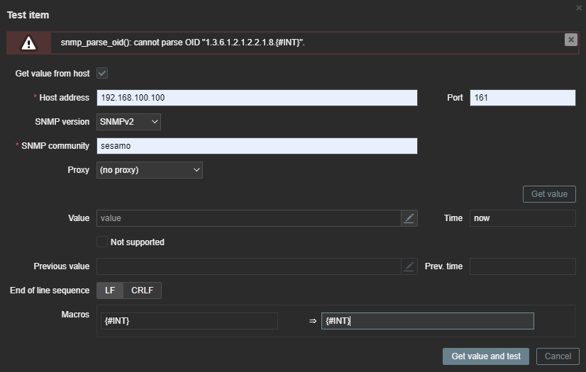

                      • un tecnico mas
                        • Apr 2022
                        • 10
                        I created a new item prototype as you said, but it didn't work.
                        • Item prototype
                        • Test
                        ​​​​​​​I am very confused about this issue

                          Hello, sorry i did not answer.
                          Do not try to test the item prototype, perform the test operation in the discovery object.
                          It should work now
                          Regards

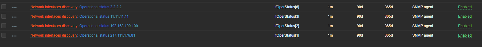

                          • un tecnico mas
                            • Apr 2022
                            • 10
                            #15
                            Hi, I have managed to create the items for the ips, but that is not what I need.
Name:	2022-06-03 15_50_11-Window.png
                            So I can't retrieve more information about the interfaces, as it doesn't group them well.
                            How can I collect the name, description of these interfaces? I need to filter the discovered interfaces, I have to discover the ones that have IP, trunk or have MONIT_SI in the description.
