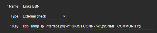

      Hello.
      I have write a Python Script to resolve this problem. I am not a python expert scripter =) you are free to improve the code
      Just need to configure a LLD with external check, using the parameters
      "-h", "{HOST.CONN}", "-c", "{$SNMP_COMMUNITY}"
