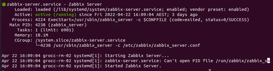

    I have updated Ubuntu 20.04 to 20.04.4 and now my server stopped running.
    I tried changing cache size to 27M, 64M, 1G, and even to 64G but nothing seems to be working.
    By checking the status zabbix-server.service,
    it was giving PID error:
    zabbix-server.service: can't open PID file /run/zabbix/zabbix_server.pid (yet?) after start: operation not permitted
    I have tried restarting the services but nothing seems to be working
    Please, refer to the attached images for a better understanding of the situation. Thank you in Advance!

    Based on that picture, everything should be running already for 3 days...
    That pid file error can be avoided with pointing pid file location to some other place in config and restarting. I have seen this, but dont remember the issue.. just /run/zabbix was not present at the time of startup.. But what was done to keep it, don't remember..:P
    You error in frontend may be related to frontend not being able to connect to server port... it does its own checks. Maybe your upgrade added some FW or other rules?

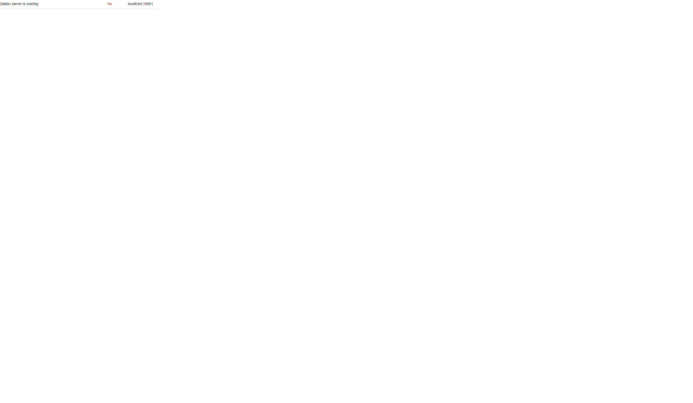

      The attached picture is what I'm getting right now. What can be done? Do you happen to know?
      Thanks : )

        I have figured it out now. My defined values weren't matching in zabbix_server.conf and zabbix.conf.php files.
