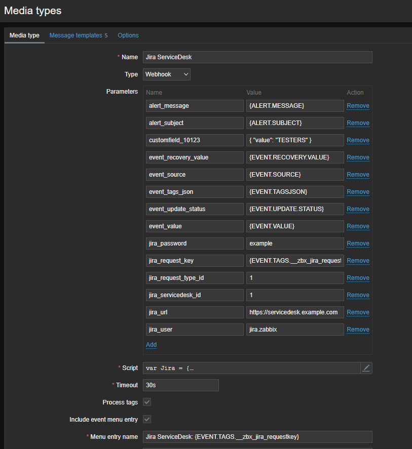

    In the Media Type, for the custom field, I have tried the following formats (the IDs are correct):
    TESTERS
    "TESTERS"
    {TESTERS}
    { TESTERS }
    {"TESTERS"}
    { "TESTERS" }
    { "value": "TESTERS" }
    { "id": 10112 }
    [{ "value": "TESTERS" }]
    [{ "id": 10112 }]
Name:	JSD Media Type.png
