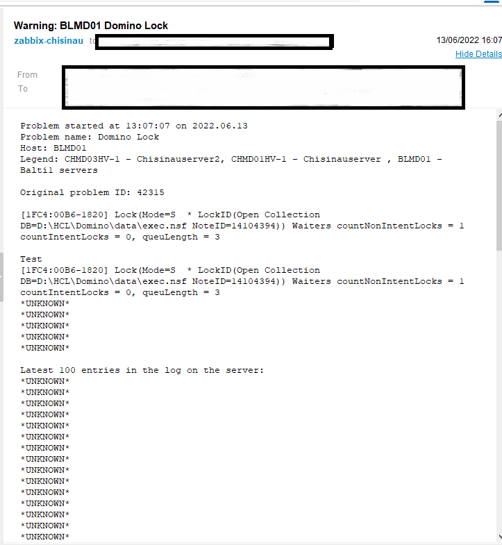

    Result I'm getting on mail:
    [1438:00D4-0F3C] Lock(Mode=S * LockID(Open Collection DB=E:\IBM\Lotus\Domino\data\slist.nsf NoteID=486)) Waiters countNonIntentLocks = 1 countIntentLocks = 0, queuLength = 7
    Latest 100 entries in the log on the server:
    *UNKNOWN*
    *UNKNOWN*
    *UNKNOWN*
    *UNKNOWN*
    *UNKNOWN*
    *UNKNOWN*
    *UNKNOWN*
    *UNKNOWN*
    *UNKNOWN*
    *UNKNOWN*

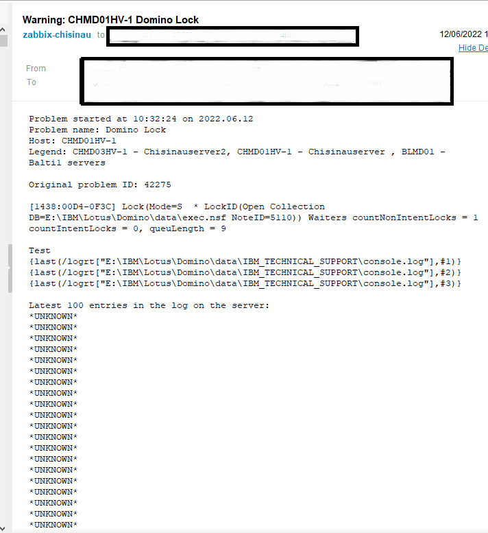

        Thank you very much for your reply. Actually I forgot to mention that I tried the syntax from the documentation and it didn't work neither. See the screenshot below (under Test section). That's why I'm asking here, as I experimented already a lot and nothing works. It worked well like this in Zabbix 5.x

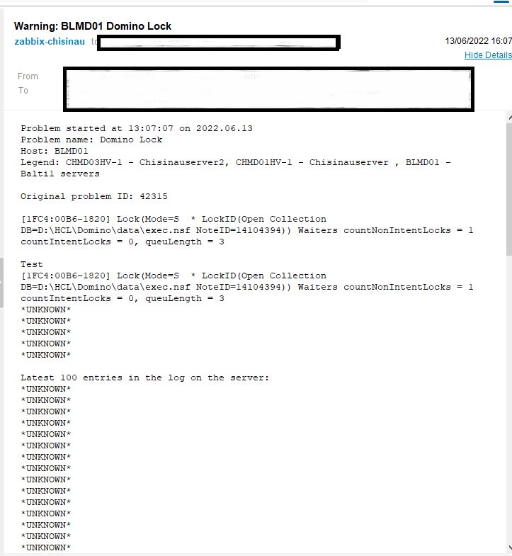

                  • radu990
                    • Oct 2017
                    • 16
                    Unfortunately that doesn't work as well. I think I'll simply give up and don't use it, I'm out of ideas already. Sad that I updated to Zabbix 6, as it was working fine on Zabbix 5 and I was happy with how it was working....
                    Actions - Operations
                    Original problem ID: {EVENT.ID}
                    {ITEM.VALUE1}
                    Test
                    last(/{HOST.HOST}/{ITEM.KEY},#1)
                    last(/{HOST.HOST}/{ITEM.KEY},#2)
                    last(/{HOST.HOST}/{ITEM.KEY},#3)
                    last(/{HOST.HOST}/{ITEM.KEY},#4)
                    last(/{HOST.HOST}/{ITEM.KEY},#5)
                    Test2
                    {?last(/{HOST.HOST}/{ITEM.KEY},#1)}
                    {?last(/{HOST.HOST}/{ITEM.KEY},#2)}
                    {?last(/{HOST.HOST}/{ITEM.KEY},#3)}
                    {?last(/{HOST.HOST}/{ITEM.KEY},#4)}
                    {?last(/{HOST.HOST}/{ITEM.KEY},#5)}
                    Test3
                    {?last(/host/key,#1)}
                    {?last(/host/key,#2)}
                    {?last(/host/key,#3)}
                    {?last(//{ITEM.KEY},#1)}
                    {?last(//{ITEM.KEY},#2)}
                    {?last(//{ITEM.KEY},#3)}
                    {?last(//{ITEM.KEY},#4)}
                    {?last(//{ITEM.KEY},#5)}

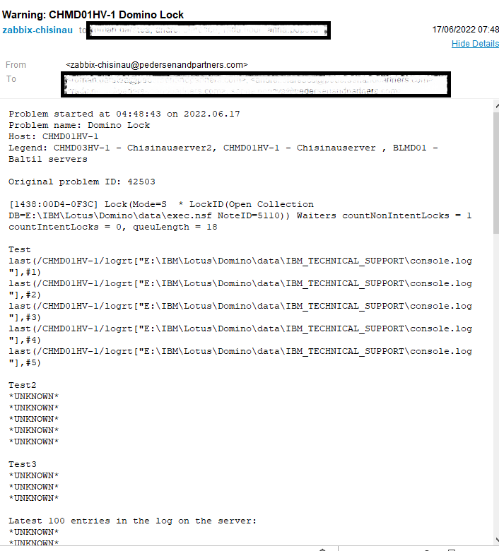

                    Result on mail:
                    Original problem ID: 42503
                    [1438:00D4-0F3C] Lock(Mode=S * LockID(Open Collection DB=E:\IBM\Lotus\Domino\data\exec.nsf NoteID=5110)) Waiters countNonIntentLocks = 1 countIntentLocks = 0, queuLength = 18
                    Test
                    last(/CHMD01HV-1/logrt["E:\IBM\Lotus\Domino\data\IBM_TECHNICAL_SUPPORT\co nsole.log"],#1)
                    last(/CHMD01HV-1/logrt["E:\IBM\Lotus\Domino\data\IBM_TECHNICAL_SUPPORT\co nsole.log"],#2)
                    last(/CHMD01HV-1/logrt["E:\IBM\Lotus\Domino\data\IBM_TECHNICAL_SUPPORT\co nsole.log"],#3)
                    last(/CHMD01HV-1/logrt["E:\IBM\Lotus\Domino\data\IBM_TECHNICAL_SUPPORT\co nsole.log"],#4)
                    last(/CHMD01HV-1/logrt["E:\IBM\Lotus\Domino\data\IBM_TECHNICAL_SUPPORT\co nsole.log"],#5)
                    Test2
                    *UNKNOWN*
                    *UNKNOWN*
                    *UNKNOWN*
                    *UNKNOWN*
                    *UNKNOWN*
                    Test3
                    *UNKNOWN*
                    *UNKNOWN*
                    *UNKNOWN*
                    *UNKNOWN*
                    *UNKNOWN*
                    *UNKNOWN*
                    *UNKNOWN*
                    *UNKNOWN*
                    Click image for larger version  Name:	zabbix3.png Views:	0 Size:	74.5 KB ID:	446433

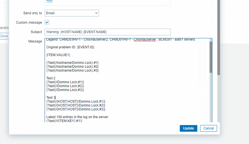

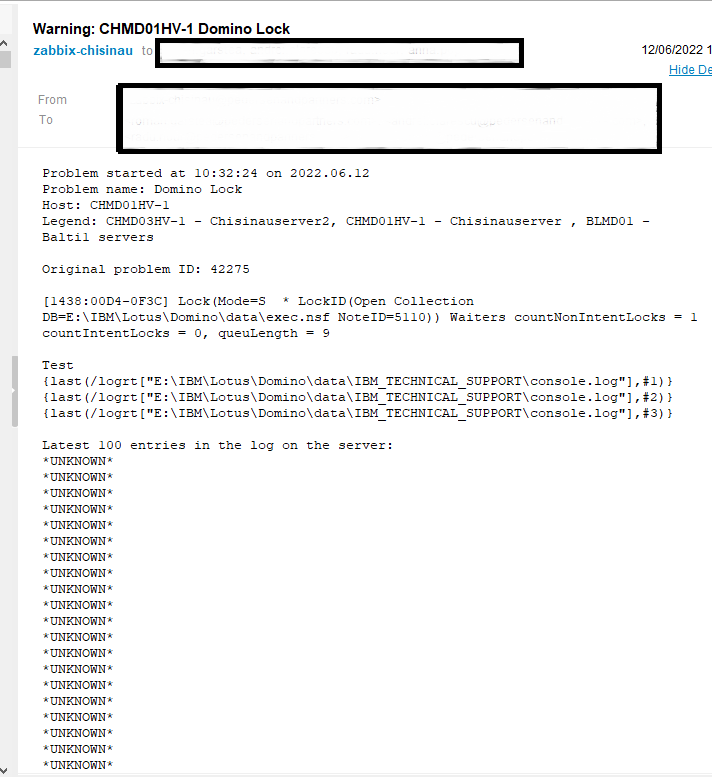

                          {ITEM.VALUE1}
                          {?last(/hostname/Domino Lock),#1}
                          {?last(/hostname/Domino Lock),#2}
                          {?last(/hostname/Domino Lock),#3}
                          Test 2
                          {?last(//Domino Lock,#1)}
                          {?last(//Domino Lock,#2)}
                          {?last(//Domino Lock,#3)}
                          Test 3
                          {?last(/{HOST.HOST}/Domino Lock,#1)}
                          {?last(/{HOST.HOST}/Domino Lock,#2)}
                          {?last(/{HOST.HOST}/Domino Lock,#3)}
                          Click image for larger version  Name:	zabbix5.png Views:	0 Size:	110.3 KB ID:	446557

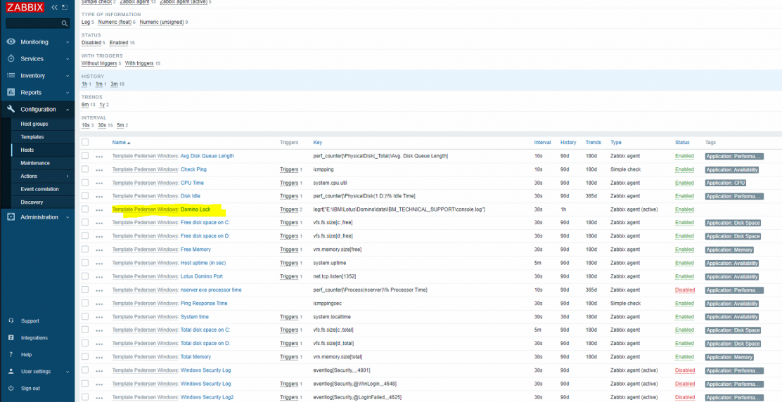

                          Item:

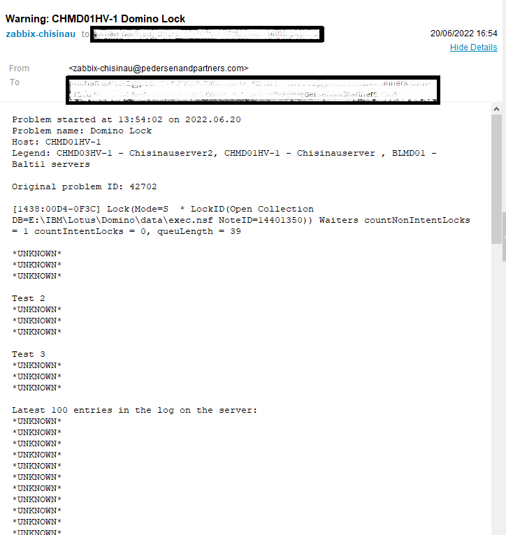

                          Result:
                          Click image for larger version  Name:	zabbix4.png Views:	0 Size:	66.8 KB ID:	446556

                              You mean to set it like this?
                              Test 1
                              {?last(/hostname/logrt["E:\IBM\Lotus\Domino\data\IBM_TECHNICAL_SUPPOR T\console.log"]),#1}
                              {?last(/hostname/logrt["E:\IBM\Lotus\Domino\data\IBM_TECHNICAL_SUPPOR T\console.log"]),#2}
                              {?last(/hostname/logrt["E:\IBM\Lotus\Domino\data\IBM_TECHNICAL_SUPPOR T\console.log"]),#3}
                              Test 2
                              {?last(//logrt["E:\IBM\Lotus\Domino\data\IBM_TECHNICAL_SUPPOR T\console.log"],#1)}
                              {?last(//logrt["E:\IBM\Lotus\Domino\data\IBM_TECHNICAL_SUPPOR T\console.log"],#2)}
                              {?last(//logrt["E:\IBM\Lotus\Domino\data\IBM_TECHNICAL_SUPPOR T\console.log"],#3)}
                              Test 3
                              {?last(/{HOST.HOST}/logrt["E:\IBM\Lotus\Domino\data\IBM_TECHNICAL_SUPPOR T\console.log"],#1)}
                              {?last(/{HOST.HOST}/logrt["E:\IBM\Lotus\Domino\data\IBM_TECHNICAL_SUPPOR T\console.log"],#2)}
                              {?last(/{HOST.HOST}/logrt["E:\IBM\Lotus\Domino\data\IBM_TECHNICAL_SUPPOR T\console.log"],#3)}

                                #15
                                Yes, but your Test 1 has incorrect order in parenthesis, and instead of "hostname" you should use the actual host name in Zabbix.
                                (Also I don't know where the suspicious spaces are coming from but beware of them)
