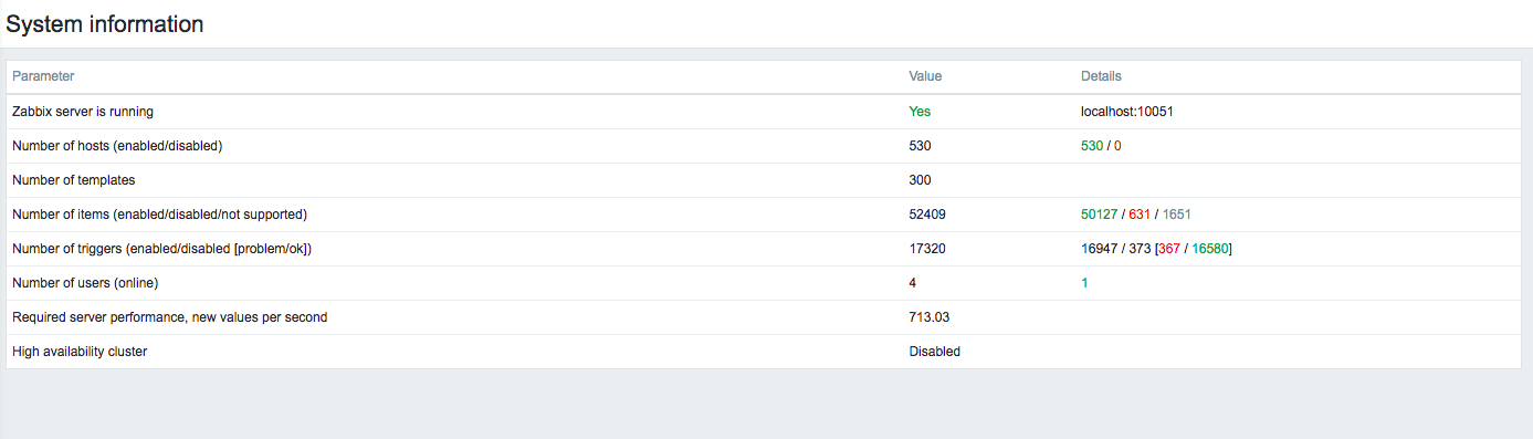

          Share your screenshot of Reports->System information
            I have attached the screenshot for the same.

              By your NVPS would be nice to have at least 8 GB RAM
