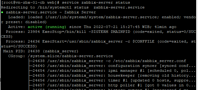

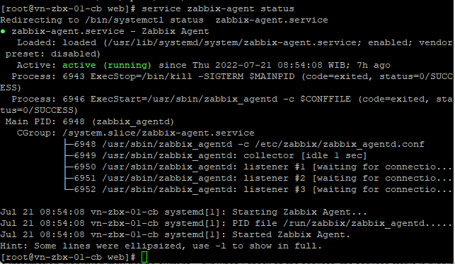

    Hi All,
    I'm using zabbix server version 4.4.1 and I'm facing this warning on the website UI "Zabbix server is not running: the information displayed may not be current" , but when I check on the services, the services status is running both of zabbix-server and zabbix-agent. I tried to add size CacheSize, HistoryCacheSize, TrendCacheSize, HistoryTextCacheSize, ValueCacheSize followed as this forum said : https://www.zabbix.com/forum/zabbix-...not-be-current , but no luck.
    Hosts : more than 1000
    and on the zabbix.conf.php by default setup.
    ZBX_SERVER = "with local IP"
    Please assist me to solve this warning that appearing on the web UI.
    Thank you
    Regards,

    Uploaded picture zabbix status

      Does the correct DB server parameters is provided in /etc/zabbix/web/zabbix.conf.php?
        Your screenshot of 'service zabbix-server status' shows that two processes exited and not running if I'm right.(the two entries with code=exited)
        Please try to restart and have a look if the problem is gone. Otherwise look in den zabbix-server.log for the problem.
        • comfyhorizon
          • Jul 2022
          check the log services to see what is displayed

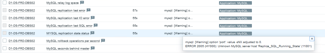

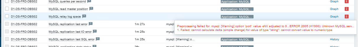

            I need help to monitoring Mysql Service on the client server, mysql service runs in failover cluster Windows Server. and If I want to know replica status, I should login to mysql and type command "show replica status;", but I tried to follow this link : https://www.zabbix.com/integrations/mysql and it's working fine but there is no way to know about replica status like command as I mention, I tried to add template from this https://github.com/IHeilig/zabbix-mysql-replication , but I got some errors like this : mysql: [Warning] option 'port': value -sNX adjusted to 0.
            ERROR 2005 (HY000): Unknown MySQL server host 'Last_Error' (11001). I upload error capture from second template that I'm using from github.
            Please help me and appreciate for your comment as well.
            Thank you
