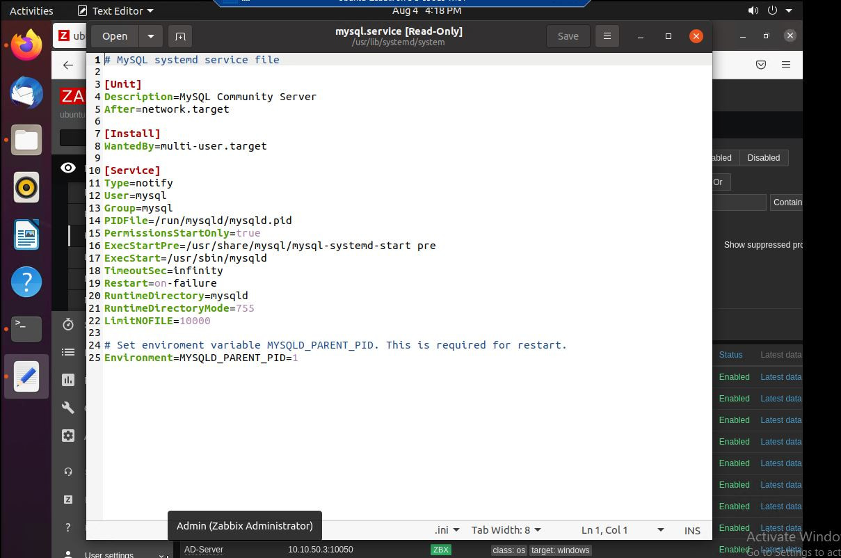

          • Fasih
            • Aug 2022
            I think it is mysql.service.
            check this image.
            • vladimir_lv
              vladimir_lv commented
              Yes, it is mysql.service.
