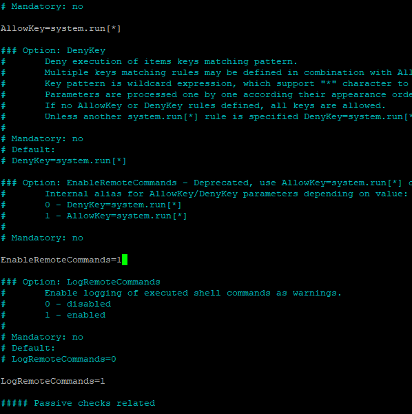

    I'm having issues with an Item key not being supported. I Created an item to run a .bat script on a Host ( system.run[C:\Bat_Softwarecheck\softwarecheck.bat] ), and get a list of installed apps with their version.
    However I quickly found out that the item key was not supported.
    I searched the issue up on the internet where everyone told me to allow the key in the config files
    /etc/zabbix/zabbix_agentd.conf with AllowKey=system.run[*]. I also added EnableRemoteCommands=1andLogRemoteCommands = 1.​
    ​I set the code on the exact same position they did and restarted my Zabbix server without any errors.
    Unfortunately the issue still wasn't solved.
    I'm using Oracle Linux Server version 8.6,
    Zabbix Agentd: 6.2.0,
    zabbix_server: 6.2.0
