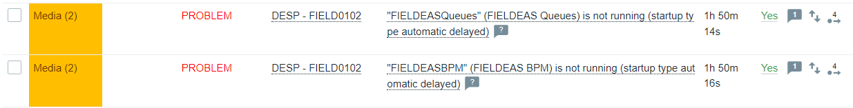

    I have a problem with alerts referring to "Windows service not running" after being disabled on Windows.
    When i started the virtual machine the two services where on automatic delayed but i dont need them for the moment so i disabled them on windows. But Zabbix is still sending me alerts about them.
    "FIELDEASBPM" (FIELDEAS BPM) is not running (startup type automatic delayed)
    min(/DESP - FIELD0102/service.info["FIELDEASBPM",state],#3)<>0
Name:	zabbix_alets_windows services.png
    Is there any way to change the value of #SERVICE.STARTUPNAME without restarting the virtual machine?
    Thanks in advance.​

    You may need to delete the triggers on the host, you can also exclude services from discovery by navigating to Administration/General/Regular Expressions. Under Windows Service Names For Discovery Add a new expression.
    Type="Result is FALSE"
    Expression = "^(<servicename>|<additional services>)$
    You can add as many services to this expression by separating them with a pipe "|". In my environment I had to set the Regular Expressions up, then manually delete the triggers on each host for the services I excluded, afterwards I no longer see those alerts.

      WRONG! Global regexes are not used in recent templates. Only in very old instances or in templates that have gone through a lot of upgrades. In most cases you need to edit corresponding macros in template.
