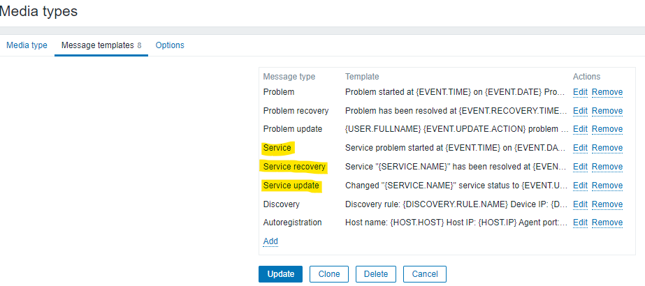

    I had similar problems, but in my case at least I could see in the action logs that the mail sending was failed due to no message was defined for media type.
    It was strange as I saw the message templates, but those are for "Problem" message type and here we need "Service" message type (3 for problem and also there are 3 for service).
    So after I added the service ones to the Message templates, it started to send out emails. I hope it helps for you or someone else who also landed on this page searching for solution for similar problem ​
