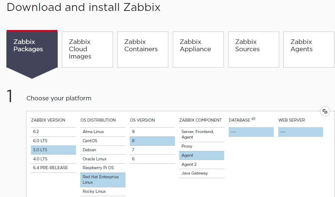

                Hi Cyber, We were looking for the Agent-2 for Linux servers. We were going by the "Zabbix Packages" under the" Download and Install Zabbix" page (Attached). The chart shows the Agent 2 showing up under the 5.0 LTS version, and 5.2 and 5.4 are not shown. We looked under "Zabbix Agents" page the Agent-2 only shows a windows agent-2 installer. Nothing for Linux. If you are saying the agent exists somewhere on our current 5.2 deployment as a binary. Could you share where that location is for us?

                      yeah, what Tim said.. Download page shows you LTS versions plus latest non-lts and a latest beta... For rest of them you should look around in repo.zabbix.com
