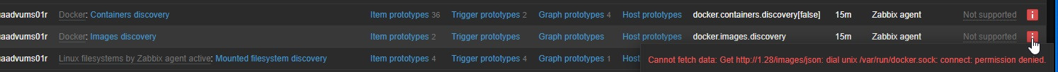

              Hi All, We managed to get the Agent2 installed on one of our servers, and added the zabbix user to the docker group. But when we discover the device, we get all the regular performance metrics but not the docker metrics, So we went down in to Items>discovery on the device and we see the attached message. Any ideas what may be going on? Click image for larger version

                It's hard to read because the letters are small, but isn't the zabbix user unable to access the socket (default: /var/run/docker.sock) for calling the Docker API? Check the socket permissions and try setting the user group as shown in the URL below.
                https://www.zabbix.com/forum/zabbix-...docker-offline

                  The two links provided did the Job, Thank you very much.
