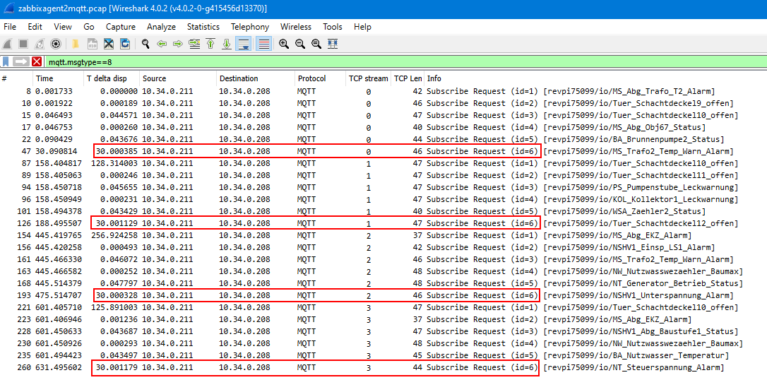

            Interesting detail btw:
            - the first 5 subscribes happen at once
            - but the 6th subscribe happens 30 seconds later
            What does it mean, I don't know
            Markku

                        In your second capture file the message identifiers (in the subscribe messages) behave very differently: using number 1 many times, then start increasing. After the reset it continues using the (same) next number again for a while, then increases it, and so on.
                        Again, I don't know what to make of it, just saying.
