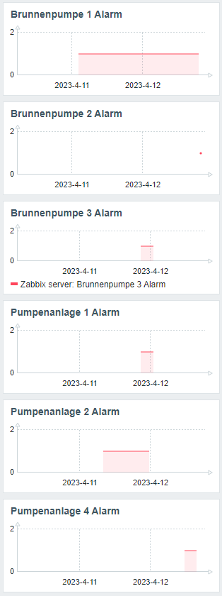

    Strange is, after the Upgrade to 6.4 and after some restarts/reboots sometimes data is received and sometimes not.
    In following screenshot you see the widgets from the items when data was received and when not:

      Based on your earlier packet capture and the analysis in message number 4 in this thread, the agent disconnects the TCP session earlier than it should. Thus it is natural that data is not collected properly.
      If I were you I would try to find the make-or-break level: how many items you need to have to get the problem reliably reproduced (if you think it is related to the number of MQTT items), or whatever information is needed so that you can open a ticket on support.zabbix.com due to a software bug. Use packet analysis as needed.
