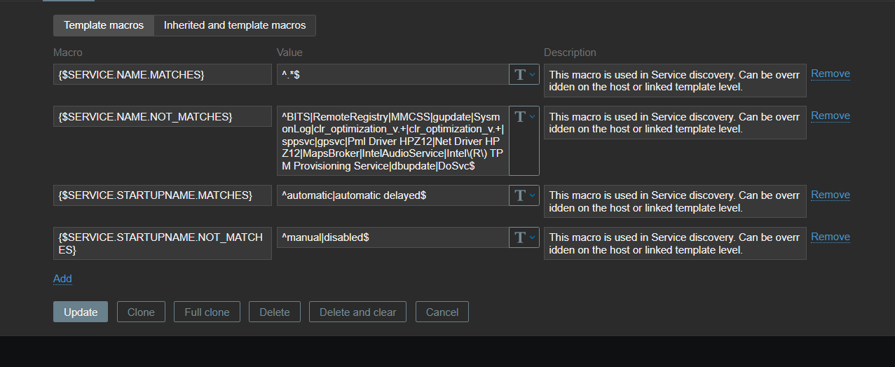

    For the record, the template macros under OS - Windows via agent are set as follows:

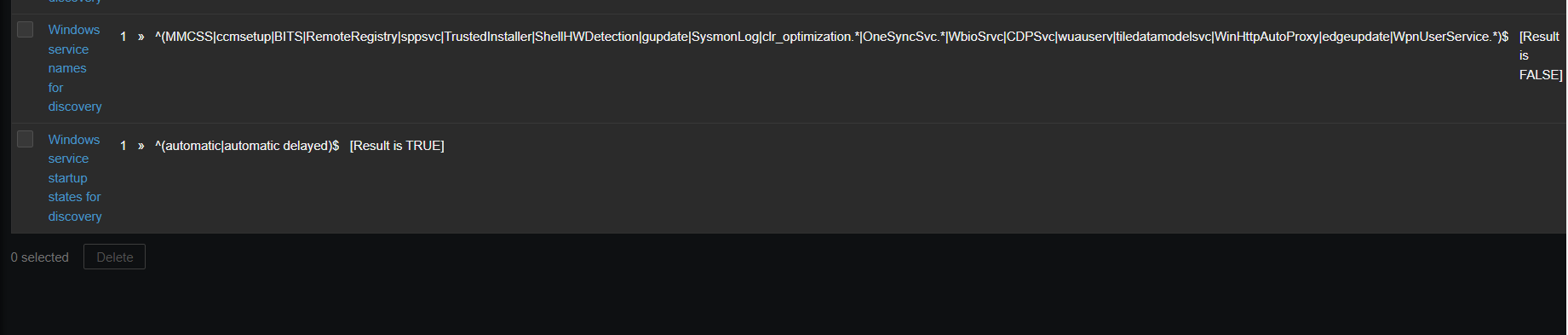

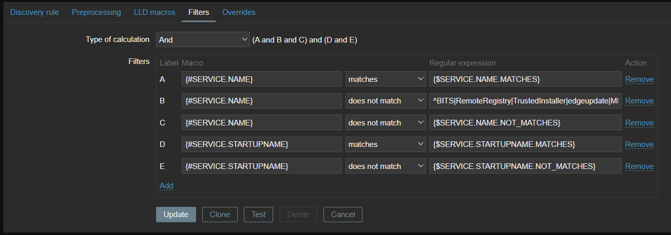

    The filters in Module - Windows services via agent are set as follows:

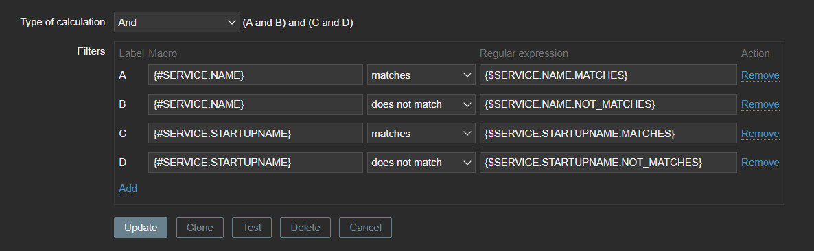

              Just following up on this, I have tried the following through system settings > regular expressions
              And through the OS - Windows via agent template
              However, the issue persists. I even experimented with deleting some servers and re-adding them to Zabbix to see if the issue clears. However, I am at a bit of a loss. If anyone can help, it would be greatly appreciated.​
