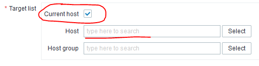

            try in operations options
            Click image for larger version  Name:	z1.png Views:	0 Size:	7.0 KB ID:	458321
            and check that you are editing the action for triggers (not for discovery or autoreg ).
            • Zabbix_Julian
              • Jul 2022
              • 25
              Thank you verry much! I added the Host but forgot the mark on "Current host". It works now, thank you!
