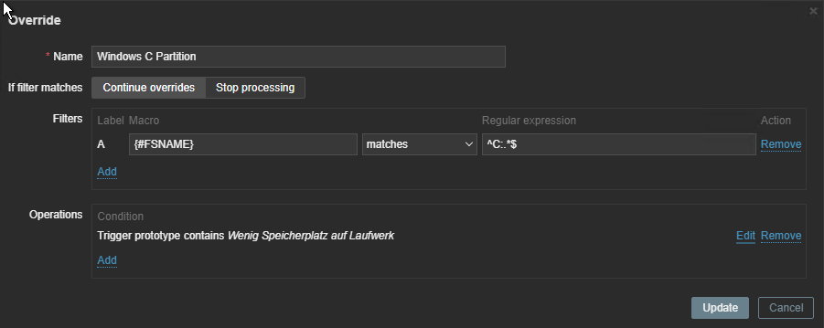

      • kswg
        • Aug 2021
        Exactly what I need! Thank you so much. I spend so much time to find a solution. I'm quiet new to zabbix.
        Now I've added two overrides to the Template Discovery. One for partition C:\ Windows and one for partition / root for linux.
        Click image for larger version  Name:	image.png Views:	1 Size:	26.4 KB ID:	459458​
        Click image for larger version  Name:	image.png Views:	1 Size:	22.6 KB ID:	459459
        The created triggers on the hosts will updated after the time set in the LLD itself.​
