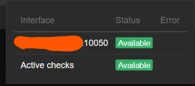

    Hello, im having problems with template "MongoDB node by Zabbix agent 2" on Zabbix 6.4 - agent version on mongo host - Zabbix Agent 2 (6.4.0)
    I have set macroces and have tested that user can login into mongodb

    agent working on mongodb

    But when i check items of mongo db template i see that all of the items are not supported:
