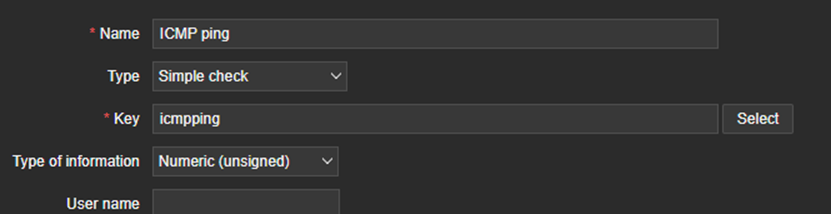

    I would like to create two ping items.
    First item must ping the AGENT interface​
    while the second has to ping the SNMP interface​
    It’s possible ?
    How should the Key be changed?
    How can I reference the desired interface?

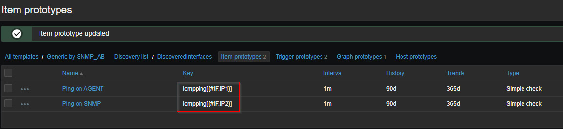

        I try to explain to you what I can't do, if you have the patience to read me.
        I configured discovery --> zabbix[host,discovery,interfaces]
        I configured the item for ping --> icmpping[{#IF .IP}]
        Everything works fine.
        Now my doubts begin....
        I would like to get a graph with this layout
        HOST1 StatusPingInterfaceAGENT StatusPingInterfaceSNMP
        HOST2 StatusPingInterfaceAGENT StatusPingInterfaceSNMP
        HOST3 StatusPingInterfaceAGENT StatusPingInterfaceSNMP
        To get it I think it is necessary to have 2 items that do the ping;
        The first item must ping on the AGENT interface
        The other item must ping on the SNMP interface
        What I can't understand (forgive me) is if there is a way, a filter, a regexp to refers to a specific interface (among those discovered) in the creation of the prototype items.
        Thank you for the time you have dedicated to me.
        I swear the documentation has been read and re-read.
        Have a good day
        Andrea
          No IP1 ort IP2 there.. only one prototype item! Discovery will loop through the initial data and create multiple items based on that prototype...
          you can use "Ping on {#IF.TYPE}" as name and "icmpping[{#IF.IP}" as key. Whatever amount of interfaces you may have there, discovery will make one item per interface...
