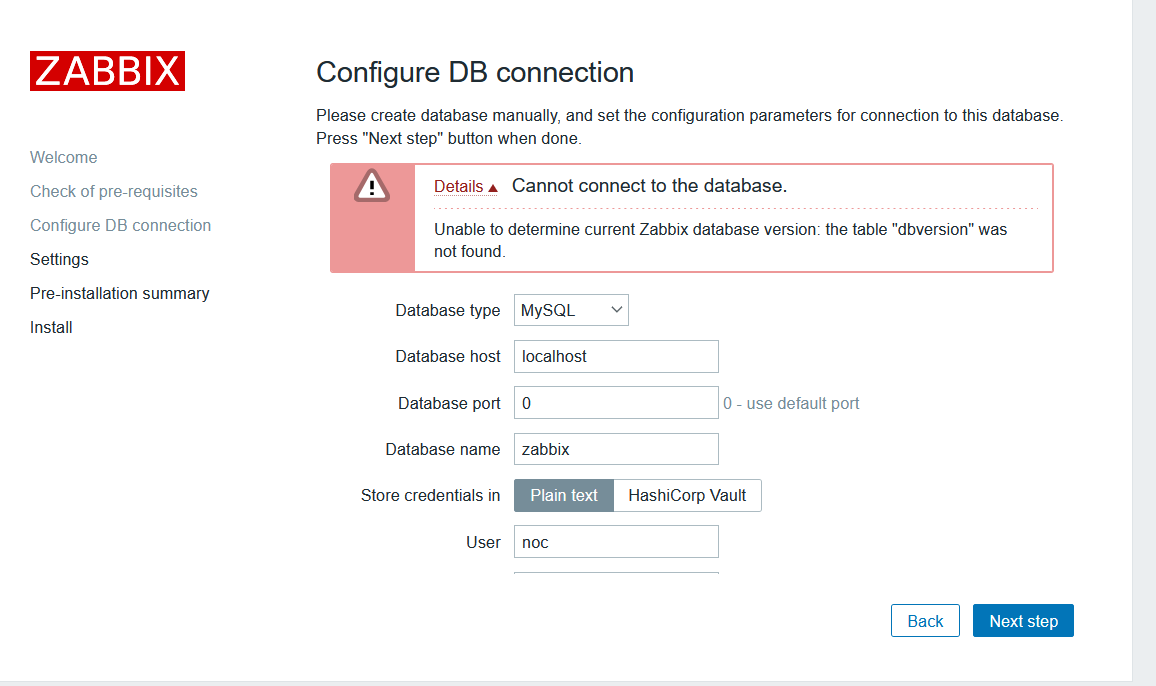

    Details Cannot connect to the database.
    I have got with this: Unable to determine current Zabbix database version: the table "dbversion" was not found. I have tried many time, however, I could not fix this.
    Please help me to solve this.
    (the detail in the image)
    Thank you,
    Paul,
    dbversion is the first table it checks, if it cannot find it, check your DB, if you schema is in place.
    • paulhung
      • Feb 2023
      • 12
      Thank you. Let me check it.

        I still get this error:
        sudo zcat /usr/share/doc/zabbix-server-mysql*/create.sql.gz | mysql -u zabbix -p <passofzabbix>
        Enter password: gzip: /usr/share/doc/zabbix-server-mysql*/create.sql.gz: No such file or directory
        ERROR 1045 (28000): Access denied for user 'zabbix'@'localhost' (using password: NO)​
        ~# mysql
        Welcome to the MariaDB monitor. Commands end with ; or \g.
        Your MariaDB connection id is 5841
        Server version: 10.11.2-MariaDB-1:10.11.2+maria~ubu2004 mariadb.org binary distribution
        Copyright (c) 2000, 2018, Oracle, MariaDB Corporation Ab and others.
        Type 'help;' or '\h' for help. Type '\c' to clear the current input statement.
        MariaDB [(none)]> use zabbix;
        Database changed
        MariaDB [zabbix]> show tables;
        Empty set (0.000 sec)
        MariaDB [zabbix]>​
        Please help!
        Thanks,
        • Atsushi
          • Aug 2013
          • 2028
          What version and platform of Zabbix are you trying to install? Have you installed the zabbix-sql-scripts package?
          Depending on the version, the file to use will be the following path.
          /usr/share/zabbix-sql-scripts/mysql/server.sql.gz
          Select your Zabbix version and platform on the download page to see the instructions.

            Thank you, I missed the schema. Now I have fixed, It is done.
            Thanks again.
