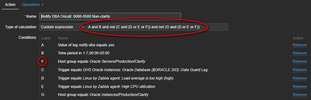

    Now I am now looking to configure the rest of the alerting during that timeframe so anything else fires a page immediately across those two host groups and their parent groups (anything with the notify-dba tag equaling yes). Based on my limited logic ability, I think this should work:
    However, when I click update to save/close the action and then re-edit the action, everything is scrambled as shown below. Conditions end up with different letters assigned and the custom logic is different and all messed up (technical term).

    I am having the same problem with the Trigger Action that uses a custom expression.
    After entering my 4 conditions and saving the Action the displayed labels for my conditions show as B, C, D and A. I then entered a Custom expression as "(B or C) and D and A". After I update the Action the custom expression is changed to "(A or B)" and C and D" but the labels and the order of the Conditions shown are not changed and still list as B, C, D and A.
    I feel that this may be an display issue on the page since the condition still seems to be working as it should if the expression was "(B or C) and D and A" even though the Custom expression is showing "(A or B) and C and D". The displayed Custom expression would match the order of the conditions if the Label was always A, B, C, and D.

      The Custom expression worked from when I first entered the Conditions and Custom expression but once I tried to update the Custom Expression to match the Condition Labels the action became out of sync with the reality of the labels and failed. I changed from a Custom Expression to an "And/Or" Type of calculation and the Action is now working as expected.
      The Action > Type of calculation "Custom expression" is broken and needs to be looked at as will rearrange the order and labels to something you are not expecting if you edit the calculation value "(A or B) and C and D" after your Action has been saved.
