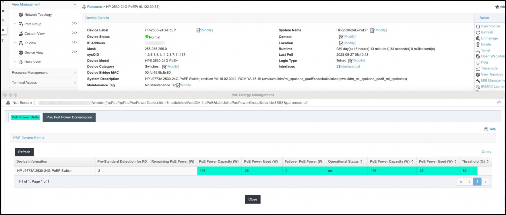

    What I really, really would like to get back via SNMP is data on the POE power consumption. This because the 2530 switches can only be populated with about half of the ports with Cisco accesspoints before the POE watt is not enough and the switch start to malfunction.
    I think that it should be possible to get the POE power consumption through SNMP, because we also use a tool from HP called iMC, and there it does collect POE data.
    I would suggest that iMC has no other "magic connection" to the switch than using SNMP and MIB's to collect this data, so it should in other words be possible to get this via SNMP also to Zabbix, right?
