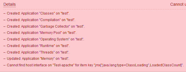

          How to monitor apache tomcat8 using zabbix in centos
          While i am adding the template jmx generic i am getting the error. pfa . Can u help where is the wrong.
