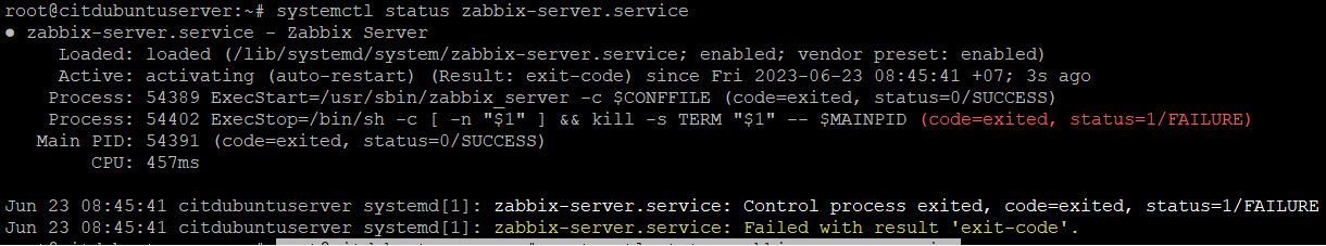

    My Zabbix Server is not running
    HOw can I resolved this problem? Thank you!
    My Zabbix server is 6.4.3. It work OK with about 30 cisco devices SNMP host, when I add more SNMP Cisco devices, the Zabbix server auto stop/restart and cannot runing. When I check zabbix server it has error,

    This is my check log Zabbix, the last log:
     53863:20230623:083318.485 ================================
     53863:20230623:083318.485 === Backtrace: ===
     53863:20230623:083318.487 12: /usr/sbin/zabbix_server: configuration syncer [syncing configuration](zbx_backtrace+0x5d) [0x5575624d0dad]
     53863:20230623:083318.487 11: /usr/sbin/zabbix_server: configuration syncer [syncing configuration](__zbx_shmem_malloc+0x68) [0x557562406c38]
     53863:20230623:083318.487 10: /usr/sbin/zabbix_server: configuration syncer [syncing configuration](zbx_vector_ptr_append+0x7e) [0x55756243371e]
     53863:20230623:083318.487 9: /usr/sbin/zabbix_server: configuration syncer [syncing configuration](+0x1bd148) [0x557562379148]
     53863:20230623:083318.487 8: /usr/sbin/zabbix_server: configuration syncer [syncing configuration](DCsync_configuration+0x46f1) [0x557562394d21]
     53863:20230623:083318.487 7: /usr/sbin/zabbix_server: configuration syncer [syncing configuration](dbconfig_thread+0x116) [0x55756224cda6]
     53863:20230623:083318.487 6: /usr/sbin/zabbix_server: configuration syncer [syncing configuration](zbx_thread_start+0x24) [0x55756240eb74]
     53863:20230623:083318.487 5: /usr/sbin/zabbix_server: configuration syncer [syncing configuration](+0x8efe8) [0x55756224afe8]
     53863:20230623:083318.487 4: /usr/sbin/zabbix_server: configuration syncer [syncing configuration](MAIN_ZABBIX_ENTRY+0xe5c) [0x55756224c46c]
     53863:20230623:083318.487 3: /usr/sbin/zabbix_server: configuration syncer [syncing configuration](main+0x257) [0x557562240f17]
     53863:20230623:083318.487 2: /lib/x86_64-linux-gnu/libc.so.6(+0x29d90) [0x7f562559ad90]
     53863:20230623:083318.487 1: /lib/x86_64-linux-gnu/libc.so.6(__libc_start_main+0x80) [0x7f562559ae40]
     53863:20230623:083318.487 0: /usr/sbin/zabbix_server: configuration syncer [syncing configuration](_start+0x25) [0x557562248265]
     53863:20230623:083318.487 [file:dbconfig.c,line:109] __zbx_shmem_malloc(): out of memory (requested 256 bytes)
     53863:20230623:083318.487 [file:dbconfig.c,line:109] __zbx_shmem_malloc(): please increase CacheSize configuration parameter
     53860:20230623:083318.607 One child process died (PID:53863,exitcode/signal:1). Exiting ...
     53861:20230623:083318.607 HA manager has been paused
     53861:20230623:083318.622 HA manager has been stopped
     53860:20230623:083318.626 Zabbix Server stopped. Zabbix 6.4.3 (revision a6c7751b021).

     53881:20230623:083353.374 required mandatory version: 06040000
     53882:20230623:083353.389 starting HA manager
     53882:20230623:083353.400 HA manager started in active mode
     53881:20230623:083353.402 server #0 started [main process]
     53884:20230623:083353.405 server #2 started [configuration syncer #1]
     53883:20230623:083353.410 server #1 started [service manager #1]
     53884:20230623:083354.393 __mem_malloc: skipped 0 asked 256 skip_min 18446744073709551615 skip_max 0
     53884:20230623:083354.394 === memory statistics for configuration cache ===
     53884:20230623:083354.394 free chunks of size     24 bytes:       27
     53884:20230623:083354.394 free chunks of size     32 bytes:        4
     53884:20230623:083354.394 min chunk size:         24 bytes
     53884:20230623:083354.394 max chunk size:         32 bytes
     53884:20230623:083354.394 memory of total size 29094672 bytes fragmented into 278712 chunks
     53884:20230623:083354.394 of those,        776 bytes are in       31 free chunks
     53884:20230623:083354.394 of those,   29093896 bytes are in   278681 used chunks
     53884:20230623:083354.394 of those,    4459376 bytes are used by allocation overhead
     53884:20230623:083354.394 ================================
     53884:20230623:083354.394 === Backtrace: ===
     53884:20230623:083354.396 12: /usr/sbin/zabbix_server: configuration syncer [syncing configuration](zbx_backtrace+0x5d) [0x55ed652dddad]
     53884:20230623:083354.396 11: /usr/sbin/zabbix_server: configuration syncer [syncing configuration](__zbx_shmem_malloc+0x68) [0x55ed65213c38]
     53884:20230623:083354.396 10: /usr/sbin/zabbix_server: configuration syncer [syncing configuration](zbx_vector_ptr_append+0x7e) [0x55ed6524071e]
     53884:20230623:083354.396 9: /usr/sbin/zabbix_server: configuration syncer [syncing configuration](+0x1bd148) [0x55ed65186148]
     53884:20230623:083354.396 8: /usr/sbin/zabbix_server: configuration syncer [syncing configuration](DCsync_configuration+0x46f1) [0x55ed651a1d21]
     53884:20230623:083354.396 7: /usr/sbin/zabbix_server: configuration syncer [syncing configuration](dbconfig_thread+0x116) [0x55ed65059da6]
     53884:20230623:083354.396 6: /usr/sbin/zabbix_server: configuration syncer [syncing configuration](zbx_thread_start+0x24) [0x55ed6521bb74]
     53884:20230623:083354.396 5: /usr/sbin/zabbix_server: configuration syncer [syncing configuration](+0x8efe8) [0x55ed65057fe8]
     53884:20230623:083354.396 4: /usr/sbin/zabbix_server: configuration syncer [syncing configuration](MAIN_ZABBIX_ENTRY+0xe5c) [0x55ed6505946c]
     53884:20230623:083354.397 3: /usr/sbin/zabbix_server: configuration syncer [syncing configuration](main+0x257) [0x55ed6504df17]
     53884:20230623:083354.397 2: /lib/x86_64-linux-gnu/libc.so.6(+0x29d90) [0x7f67398eed90]
     53884:20230623:083354.397 1: /lib/x86_64-linux-gnu/libc.so.6(__libc_start_main+0x80) [0x7f67398eee40]
     53884:20230623:083354.397 0: /usr/sbin/zabbix_server: configuration syncer [syncing configuration](_start+0x25) [0x55ed65055265]
     53884:20230623:083354.397 [file:dbconfig.c,line:109] __zbx_shmem_malloc(): out of memory (requested 256 bytes)
     53884:20230623:083354.397 [file:dbconfig.c,line:109] __zbx_shmem_malloc(): please increase CacheSize configuration parameter
     53881:20230623:083355.392 One child process died (PID:53884,exitcode/signal:1). Exiting ...
     53882:20230623:083355.392 HA manager has been paused
     53882:20230623:083355.408 HA manager has been stopped
     53881:20230623:083355.412 Zabbix Server stopped. Zabbix 6.4.3 (revision a6c7751b021).

     53939:20230623:083516.382 server #2 started [configuration syncer #1]
     53939:20230623:083517.584 __mem_malloc: skipped 0 asked 256 skip_min 18446744073709551615 skip_max 0
     53939:20230623:083517.584 === memory statistics for configuration cache ===
     53939:20230623:083517.584 free chunks of size     24 bytes:       27
     53939:20230623:083517.584 free chunks of size     32 bytes:        4
     53939:20230623:083517.585 min chunk size:         24 bytes
     53939:20230623:083517.585 max chunk size:         32 bytes
     53939:20230623:083517.585 memory of total size 29094672 bytes fragmented into 278712 chunks
     53939:20230623:083517.585 of those,        776 bytes are in       31 free chunks
     53939:20230623:083517.585 of those,   29093896 bytes are in   278681 used chunks
     53939:20230623:083517.585 of those,    4459376 bytes are used by allocation overhead
     53939:20230623:083517.585 ================================
     53939:20230623:083517.585 === Backtrace: ===
     53939:20230623:083517.594 12: /usr/sbin/zabbix_server: configuration syncer [syncing configuration](zbx_backtrace+0x5d) [0x55aa3b134dad]
     53939:20230623:083517.594 11: /usr/sbin/zabbix_server: configuration syncer [syncing configuration](__zbx_shmem_malloc+0x68) [0x55aa3b06ac38]
     53939:20230623:083517.594 10: /usr/sbin/zabbix_server: configuration syncer [syncing configuration](zbx_vector_ptr_append+0x7e) [0x55aa3b09771e]
     53939:20230623:083517.594 9: /usr/sbin/zabbix_server: configuration syncer [syncing configuration](+0x1bd148) [0x55aa3afdd148]
     53939:20230623:083517.594 8: /usr/sbin/zabbix_server: configuration syncer [syncing configuration](DCsync_configuration+0x46f1) [0x55aa3aff8d21]
     53939:20230623:083517.594 7: /usr/sbin/zabbix_server: configuration syncer [syncing configuration](dbconfig_thread+0x116) [0x55aa3aeb0da6]
     53939:20230623:083517.594 6: /usr/sbin/zabbix_server: configuration syncer [syncing configuration](zbx_thread_start+0x24) [0x55aa3b072b74]
     53939:20230623:083517.594 5: /usr/sbin/zabbix_server: configuration syncer [syncing configuration](+0x8efe8) [0x55aa3aeaefe8]
     53939:20230623:083517.594 4: /usr/sbin/zabbix_server: configuration syncer [syncing configuration](MAIN_ZABBIX_ENTRY+0xe5c) [0x55aa3aeb046c]
     53939:20230623:083517.594 3: /usr/sbin/zabbix_server: configuration syncer [syncing configuration](main+0x257) [0x55aa3aea4f17]
     53939:20230623:083517.594 2: /lib/x86_64-linux-gnu/libc.so.6(+0x29d90) [0x7fb3aa05ad90]
     53939:20230623:083517.594 1: /lib/x86_64-linux-gnu/libc.so.6(__libc_start_main+0x80) [0x7fb3aa05ae40]
     53939:20230623:083517.594 0: /usr/sbin/zabbix_server: configuration syncer [syncing configuration](_start+0x25) [0x55aa3aeac265]
     53939:20230623:083517.594 [file:dbconfig.c,line:109] __zbx_shmem_malloc(): out of memory (requested 256 bytes)
     53939:20230623:083517.594 [file:dbconfig.c,line:109] __zbx_shmem_malloc(): please increase CacheSize configuration parameter
     53936:20230623:083517.606 One child process died (PID:53939,exitcode/signal:1). Exiting ...
     53937:20230623:083517.607 HA manager has been paused
     53937:20230623:083517.623 HA manager has been stopped
     53936:20230623:083517.627 Zabbix Server stopped. Zabbix 6.4.3 (revision a6c7751b021).
     53947:20230623:083527.893 Starting Zabbix Server. Zabbix 6.4.3 (revision a6c7751b021).
     53947:20230623:083527.893 ****** Enabled features ******
     53947:20230623:083527.893 SNMP monitoring:           YES
     53947:20230623:083527.893 IPMI monitoring:           YES
     53947:20230623:083527.893 Web monitoring:            YES
     53947:20230623:083527.893 VMware monitoring:         YES
     53947:20230623:083527.893 SMTP authentication:       YES
     53947:20230623:083527.893 ODBC:                      YES
     53947:20230623:083527.893 SSH support:               YES
     53947:20230623:083527.893 IPv6 support:              YES
     53947:20230623:083527.893 TLS support:               YES
     53947:20230623:083527.893 ******************************
     53947:20230623:083527.893 using configuration file: /etc/zabbix/zabbix_server.conf
     53947:20230623:083527.928 current database version (mandatory/optional): 06040000/06040000
     53947:20230623:083527.928 required mandatory version: 06040000
     53948:20230623:083527.943 starting HA manager
     53948:20230623:083527.952 HA manager started in active mode
     53947:20230623:083527.954 server #0 started [main process]
     53950:20230623:083527.957 server #2 started [configuration syncer #1]
     53949:20230623:083527.959 server #1 started [service manager #1]
     53950:20230623:083528.967 __mem_malloc: skipped 0 asked 256 skip_min 18446744073709551615 skip_max 0
     53950:20230623:083528.967 === memory statistics for configuration cache ===
     53950:20230623:083528.967 free chunks of size     24 bytes:       27
     53950:20230623:083528.967 free chunks of size     32 bytes:        4
     53950:20230623:083528.967 min chunk size:         24 bytes
     53950:20230623:083528.967 max chunk size:         32 bytes
     53950:20230623:083528.967 memory of total size 29094672 bytes fragmented into 278712 chunks
     53950:20230623:083528.967 of those,        776 bytes are in       31 free chunks
     53950:20230623:083528.967 of those,   29093896 bytes are in   278681 used chunks
     53950:20230623:083528.967 of those,    4459376 bytes are used by allocation overhead
     53950:20230623:083528.968 ================================
     53950:20230623:083528.968 === Backtrace: ===
     53950:20230623:083528.969 12: /usr/sbin/zabbix_server: configuration syncer [syncing configuration](zbx_backtrace+0x5d) [0x56334dee5dad]
     53950:20230623:083528.969 11: /usr/sbin/zabbix_server: configuration syncer [syncing configuration](__zbx_shmem_malloc+0x68) [0x56334de1bc38]
     53950:20230623:083528.969 10: /usr/sbin/zabbix_server: configuration syncer [syncing configuration](zbx_vector_ptr_append+0x7e) [0x56334de4871e]
     53950:20230623:083528.969 9: /usr/sbin/zabbix_server: configuration syncer [syncing configuration](+0x1bd148) [0x56334dd8e148]
     53950:20230623:083528.969 8: /usr/sbin/zabbix_server: configuration syncer [syncing configuration](DCsync_configuration+0x46f1) [0x56334dda9d21]
     53950:20230623:083528.969 7: /usr/sbin/zabbix_server: configuration syncer [syncing configuration](dbconfig_thread+0x116) [0x56334dc61da6]
     53950:20230623:083528.969 6: /usr/sbin/zabbix_server: configuration syncer [syncing configuration](zbx_thread_start+0x24) [0x56334de23b74]
     53950:20230623:083528.969 5: /usr/sbin/zabbix_server: configuration syncer [syncing configuration](+0x8efe8) [0x56334dc5ffe8]
     53950:20230623:083528.969 4: /usr/sbin/zabbix_server: configuration syncer [syncing configuration](MAIN_ZABBIX_ENTRY+0xe5c) [0x56334dc6146c]
     53950:20230623:083528.969 3: /usr/sbin/zabbix_server: configuration syncer [syncing configuration](main+0x257) [0x56334dc55f17]
     53950:20230623:083528.969 2: /lib/x86_64-linux-gnu/libc.so.6(+0x29d90) [0x7fd956274d90]
     53950:20230623:083528.969 1: /lib/x86_64-linux-gnu/libc.so.6(__libc_start_main+0x80) [0x7fd956274e40]
     53950:20230623:083528.969 0: /usr/sbin/zabbix_server: configuration syncer [syncing configuration](_start+0x25) [0x56334dc5d265]
     53950:20230623:083528.969 [file:dbconfig.c,line:109] __zbx_shmem_malloc(): out of memory (requested 256 bytes)
     53950:20230623:083528.969 [file:dbconfig.c,line:109] __zbx_shmem_malloc(): please increase CacheSize configuration parameter
     53947:20230623:083529.946 One child process died (PID:53950,exitcode/signal:1). Exiting ...
     53948:20230623:083529.947 HA manager has been paused
     53948:20230623:083529.961 HA manager has been stopped
     53947:20230623:083529.966 Zabbix Server stopped. Zabbix 6.4.3 (revision a6c7751b021).
    root@citdubuntuserver:~$
