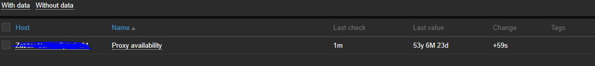

        I configured what you suggested, but I am getting a value of years, any suggestions?
        I am using version 6.2.7
        Click image for larger version  Name:	image.png Views:	1 Size:	9.6 KB ID:	467006​

          Set "Units​" to unixtime
          and trigger like fuzzytime(/host/zabbix[proxy,you_proxy_name,lastaccess],10m)=0

            Thank you!
            that works for me​
