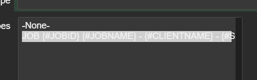

        • spaghetti
          • Apr 2023
          ISiroshtan Sure, there's one master item that the discovery rule gets the data from and the items are created as dependent. Here are the item prototypes:
          Click image for larger version  Name:	image.png Views:	0 Size:	88.0 KB ID:	468226​Each is passed to an application prototype that's created as follows:
          Click image for larger version  Name:	image.png Views:	0 Size:	6.2 KB ID:	468227
          Using LLD Macros of course

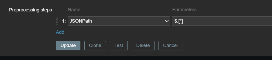

          It's preprocessed from a json:
          Click image for larger version  Name:	image.png Views:	0 Size:	8.9 KB ID:	468228
          The ID you see, goes from 0 to n, each job gets assigned one - IT IS NOT THE SAME ID IN THE NAME, it's just for preprocessing

          It is preprocessed the same way in both Discovery Rule and the master item - which is the json itself.
          Click image for larger version  Name:	image.png Views:	0 Size:	15.2 KB ID:	468229​
