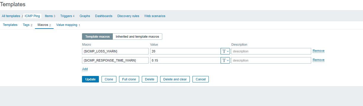

    • 4970
    Value for {$ICMP_RESPONSE_TIME_WARN} macro?
    icmppingsec returns value in seconds, so if that 200, you mention, is in milliseconds, then 0.2 should work.

    You don't need another template, you can set that macro value on host level also, so it will overrun the one from template...

      thank you for the response. This value was what i was looking for.
      Beside this trigger there are the other one but i haven´t changed the time values here.
      Any "best practise" i should set this here up? This Template is how i said a preinstalled one from Zabbix itself.
