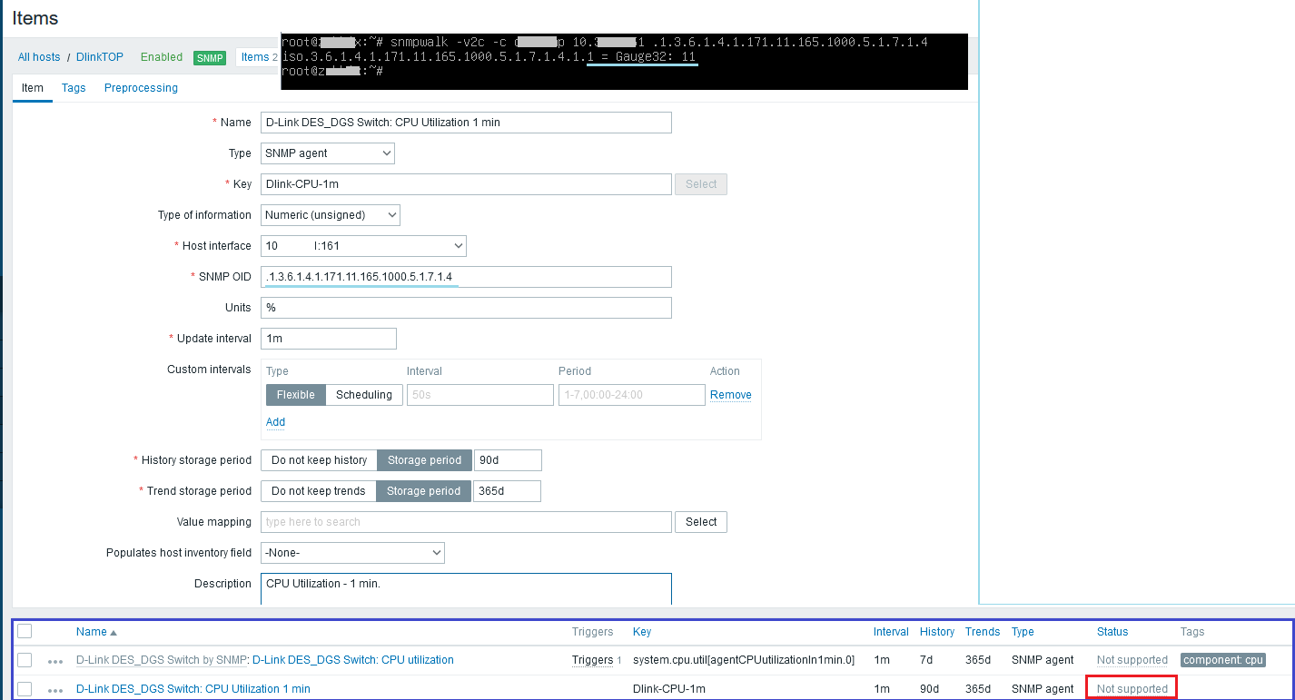

    Hello!
    Tried to create a new item to monitor DGS 1250-28's CPU but the item is reported as "Not supported" although I can successfully query it in snmpwalk in the iReasoning MIB browser:
    Would you please tell me what's wrong with this item definition?

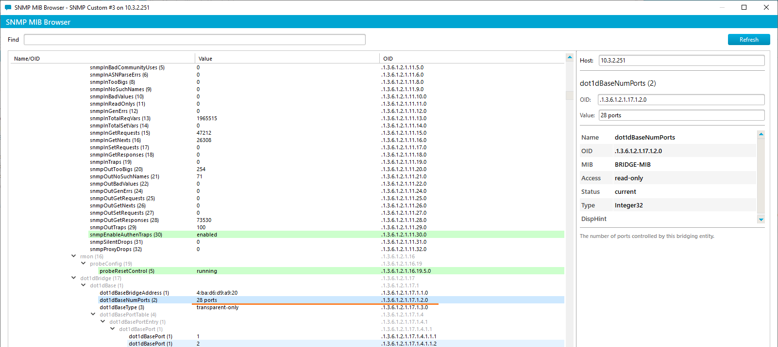

        Hello, vijayk!
        There're no problems in getting this OID either in snmpwalk or (for example) in IP Host Monitor:
        - the problem is why Zabbix keeps saying "Not supported"???
        P.S. Thank you very much for the link - I 'liked the IP Host Monitor very much!

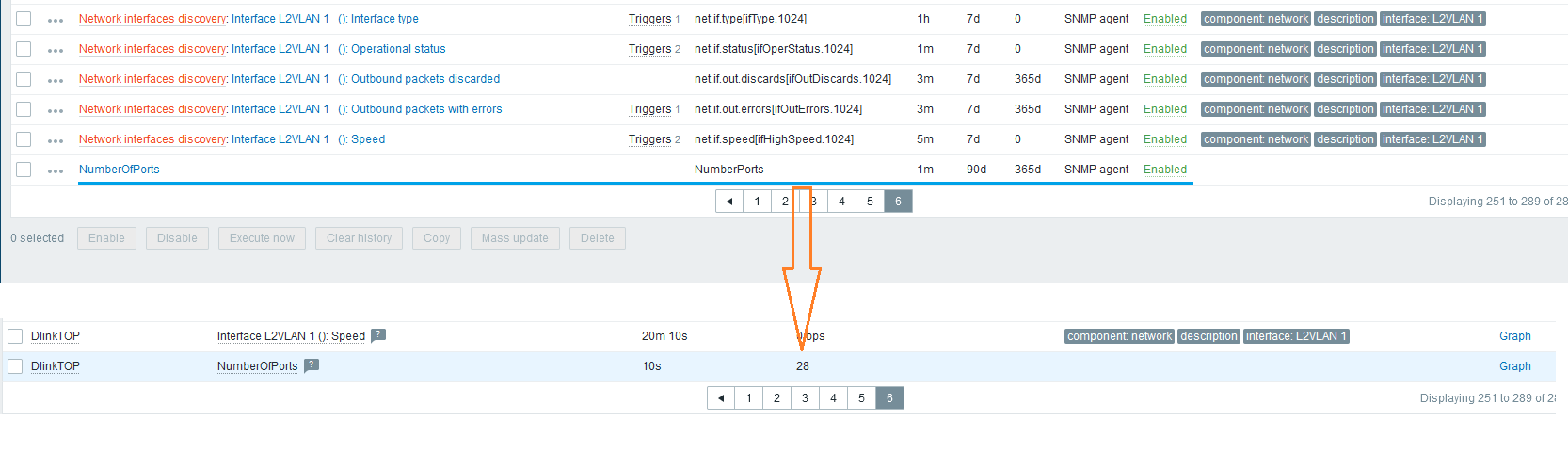

            Yes, it does! Here;s the test:
            ... can't understand why these particular OIDs (may be some other either, of course) can't be obtained ((
            .1.3.6.1.4.1.171.11.165.1000.5.1.7.1.3
            .1.3.6.1.4.1.171.11.165.1000.5.1.7.1.4
            .1.3.6.1.4.1.171.11.165.1000.5.1.7.1.5
            Is it possible that Zabbix can "see" OIDs in one "OID subtree" and can't in some other?

                Please see the very first picture of this post - it's the item for .1.3.6.1.4.1.171.11.165.1000.5.1.7.1.4 but the same goes for all others!

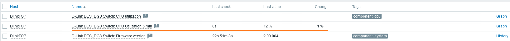

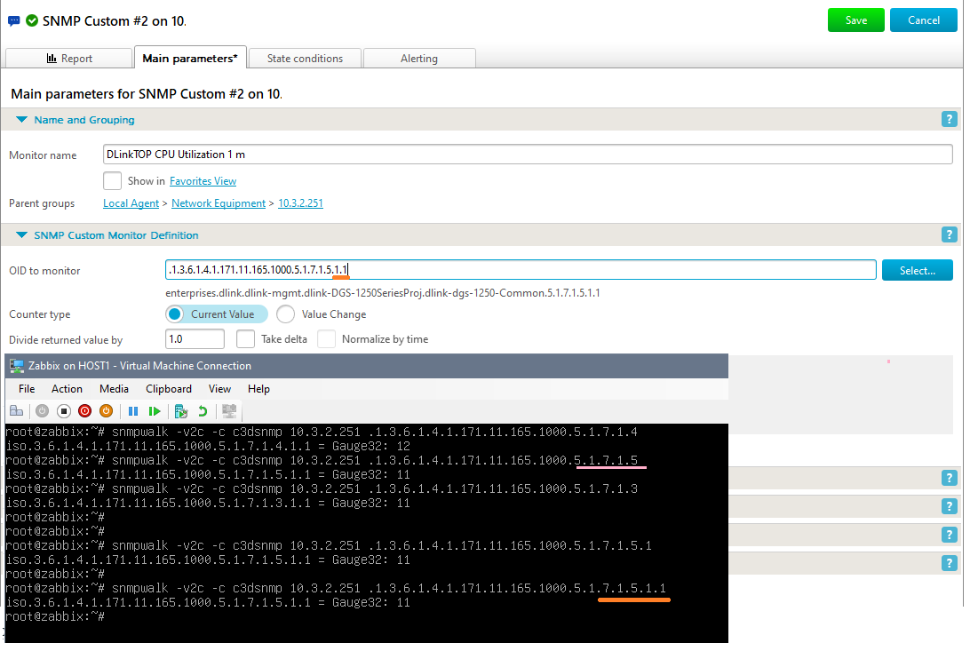

                      Vijayk, thank you so much for the IP Host Network Monitor - it really helped!!!
                      I once again looked into the monitor's OID field that I created earlier and noticed that the OID I had entered initially - .1.3.6.1.4.1.171.11.165.1000.5.1.7.1.5​ - has turned into .1.3.6.1.4.1.171.11.165.1000.5.1.7.1.5​.1.1
                      - when I entered the longer OID into Zabbix it started working!!!
                      Do you know what's the difference between .1.3.6.1.4.1.171.11.165.1000.5.1.7.1.5​ and .1.3.6.1.4.1.171.11.165.1000.5.1.7.1.5​.1.1 and why some programs (snmpwalk, for example) do work with the short version while others (Zabbix) don not?
